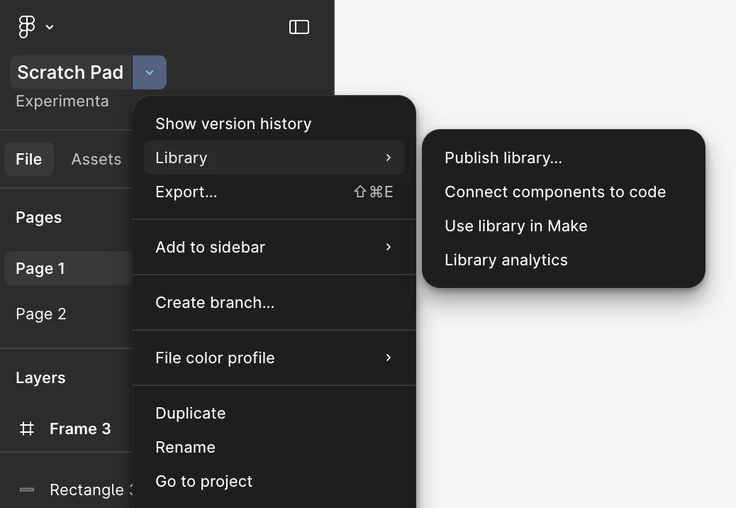

Let’s see if we can figure out together why you aren’t seeing some libraries as available for your Make kit.  For every library that you want available for Make, you’ll need to do the following:
  1. In Figma Design, go to the library you want to use in a Make kit.
  2. If you haven't yet, publish the library.
  3. Click the down arrow next to the file name, and then Use library in Make.
For those that are not showing, can you follow the steps above? I imagine that these libraries are published, but they may still need you to click to use them in Make.
Let me know if you have any trouble!

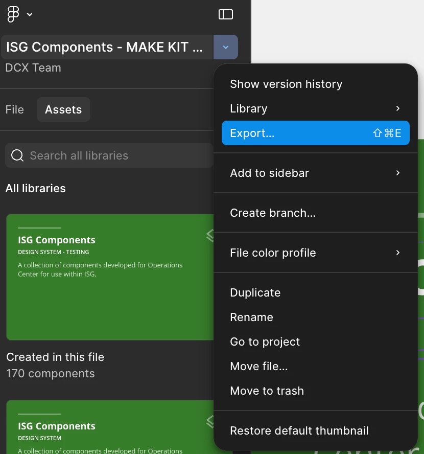

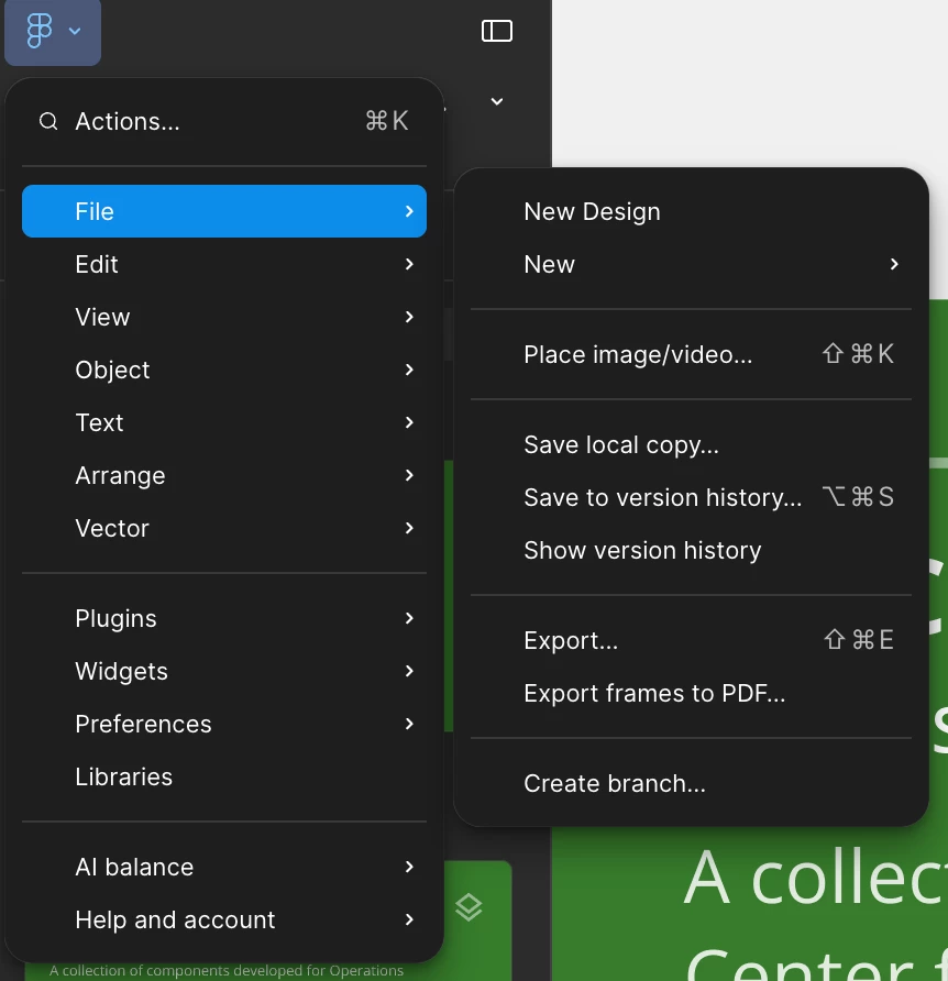

Hattie Tadsen
Running in to this same issue here. Even as owner of the library files, there is no option to Export for Make. Even when this library, prior to the change to Make Kits was exported and used in Figma Make files.
Screenshots for reference. Export from the File Name and Export from the top Figma menu.
There is an option to “Use library in Make” which then just takes me to Figma Make with the libraries dialog open and the library I’m wanting to use is not showing up.

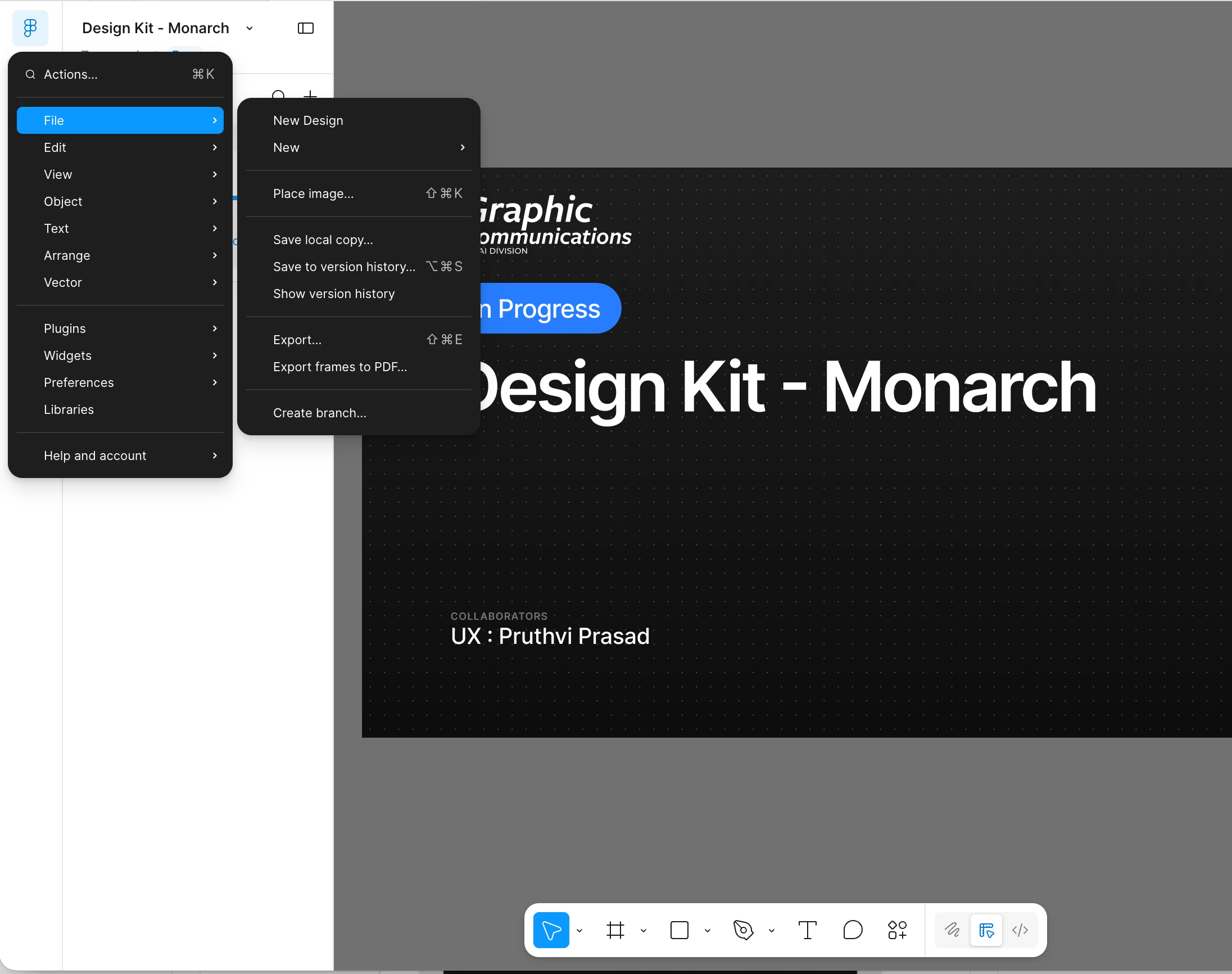

Prasad P
  • New Member
  • April 27, 2026
Facing the same issue here — the published library isn’t showing in Figma Make while assembling the kit. However, the same file is visible under the Assets section. Also, as mentioned earlier, I’m unable to find the “Export to Figma Make” option.

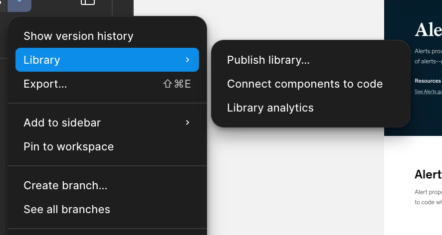

@Hattie Tadsen, you’ve already found this yourself, but for anyone else wondering which menu this is in - it’s in the Filename dropdown > Library rather than the File dropdown or Figma logo:
This particular step is covered in the help article on bringing library styles to a make kit.
If anyone has styles or variables in a published library and the option isn’t shown, let me know. I asked for clarification if there are any other nuances to this, but I can also take specific examples to them as well.
LucasGP
  • New Member
  • April 30, 2026
@adamsmasher Have you done anything specific to see the option? Mine doesn’t show
adamsmasher
  • Figmate
  • Answer
  • April 30, 2026
Thanks for the screenshot, ​@LucasGP! I actually saw that in my own file, too, and was also confused. 😅
I’ve got clarification, though, which should help for everyone in this thread who is having trouble using a library in Make.
