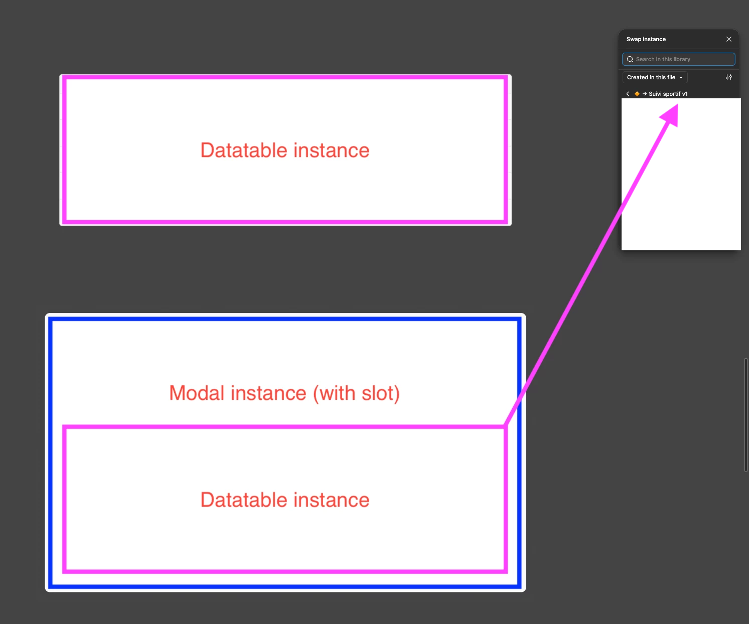

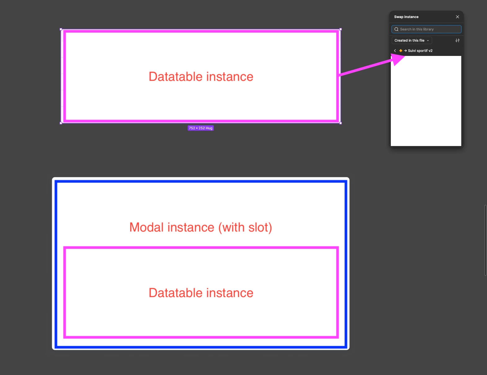

Yes, the component on Page v2 is an instance linked to the component on Page v1.
I discovered the issue when editing the component on Page v2 and not seeing the changes applied. I then selected the instance inside the modal and clicked “Go to main component”. That’s when I noticed it took me back to Page v1.
The modal is a component from a published library, my design system file, and it uses slots.
For the quick test, I tried again with another instance of the same local component placed outside the slot.
Result:
  • The instance inside the slot on Page v2 is linked to the component on Page v1.
  • The instance outside the slot on Page v2 is linked to the component on Page v2.
Based on this test, it seems that the issue is related to the slot.
Unfortunately, I won’t be able to share a screen recording publicly due to an NDA. Do you have a private way for me to send you the video?
