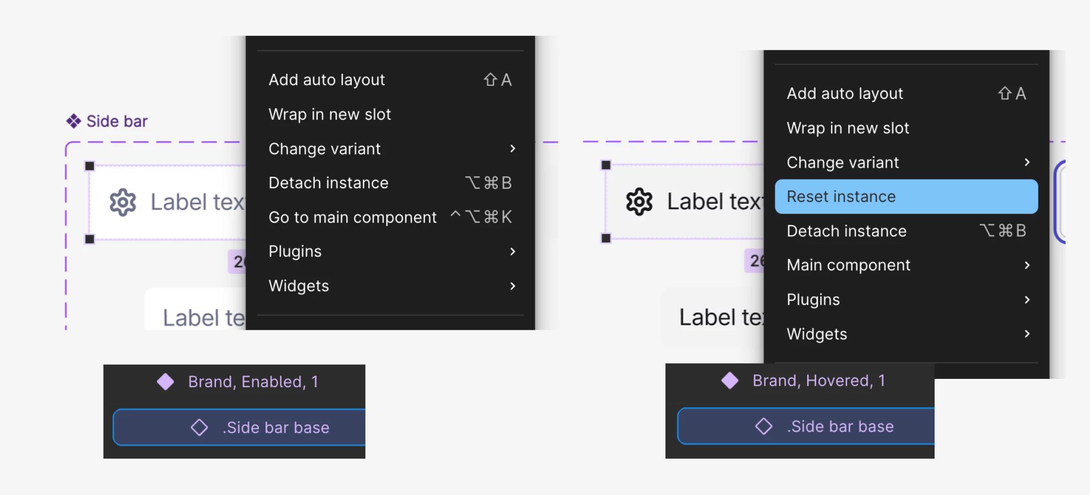

I think the problem is you are using a base component (.Side bar base)

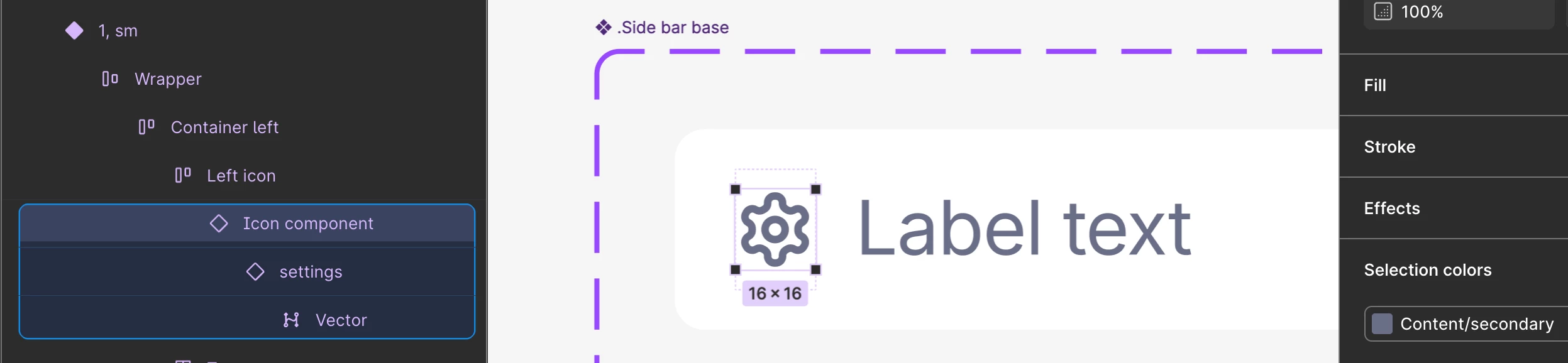

Here’s why: .Side bar base uses an instance of your Icon component, and overrides its color from your Content/primary color variable to Color/secondary:
.Side bar base is styled to be the state=Enabled variants of your downstream Side bar component. That styling becomes understood as “default”. When I tried to “reset instance” on the nested instance of .Side bar base within those state=Enabled variants of Side bar, I did not have the option because no changes have been made. This is not true when I right-click on the nested instance in the state=Hovered variants—that one has a “reset instance” option in the menu (right side of this screenshot) because the color has been overridden to again be Content/primary:
Figma seems to be getting confused about what is a color override and what isn’t… there’s a long chain of changes to keep track of:
Settings uses Content/primary… but then it gets wrapped in Icon component, which uses #000000… Icon component gets used in .Side bar base, and is overridden again to Content/secondary… but only in some variants of Side bar it gets overridden again back to Content/primary.
