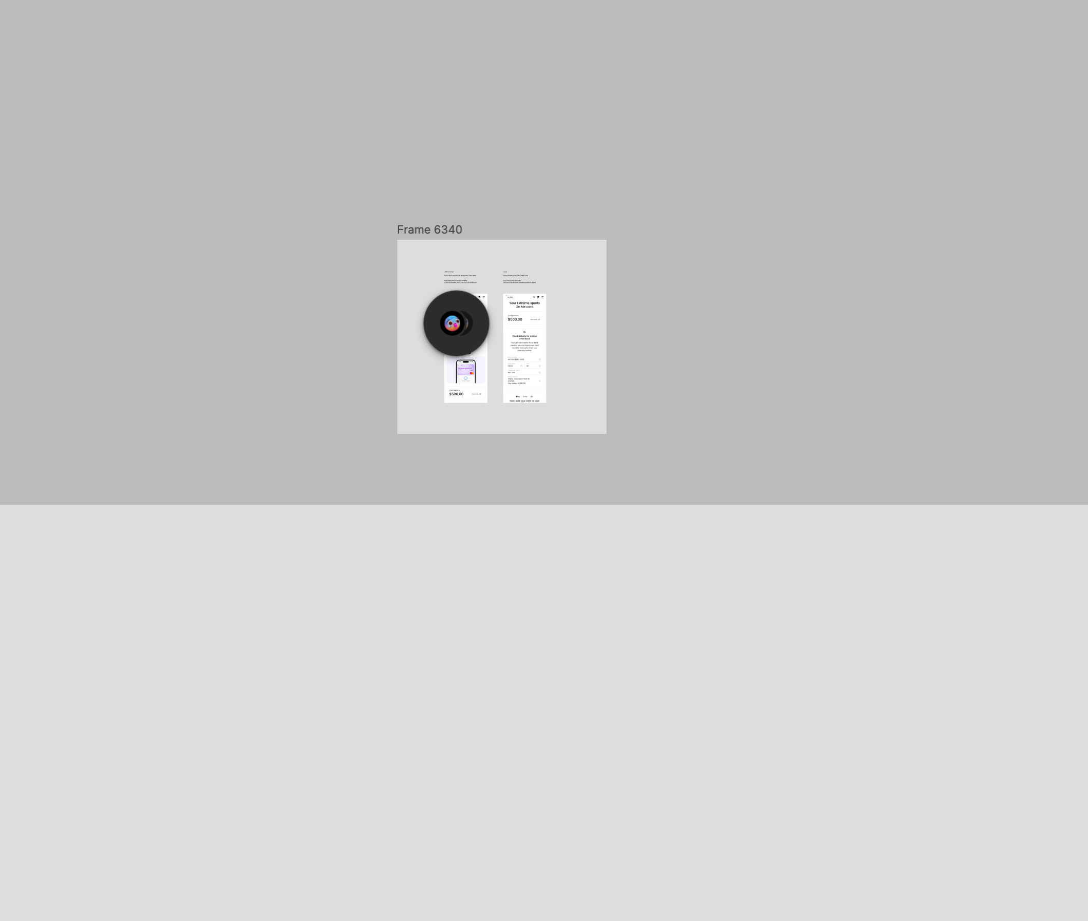

Here is a frame, with 3 comments on the frame:

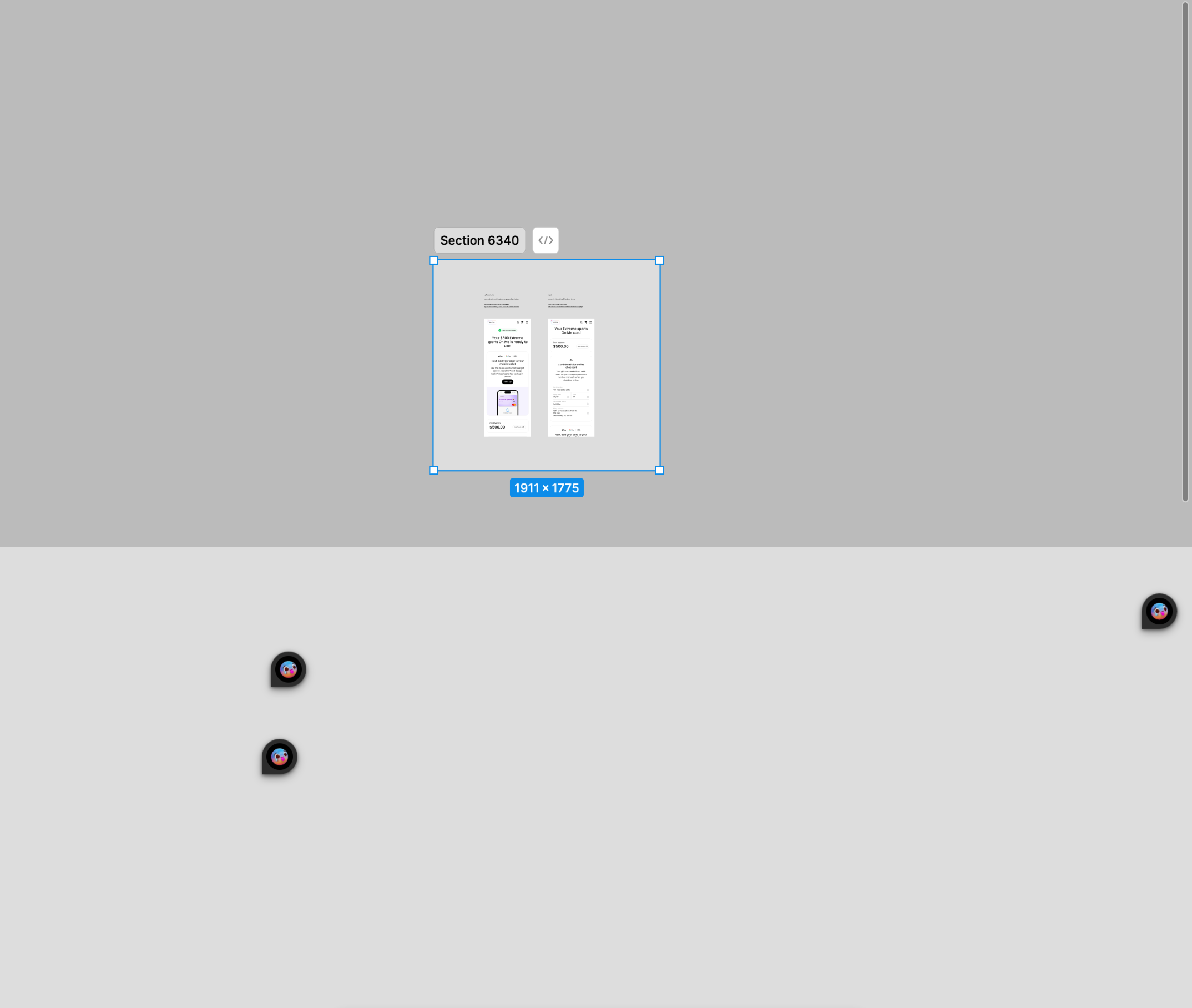

As soon as I turn the frame into a section, the comments scatter. Why does this happen?

Here is a video demonstrating the bug:
Steps to reproduce:
  1. Create a section
  2. Create a frame within the section
  3. Add 1 or more comments within the frame
  4. Move the frame outside the section
  5. Turn the frame into a section
  6. Observe that the comments jump back into the original section
