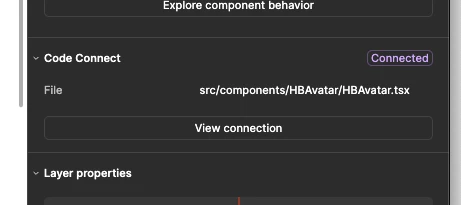

In our team’s Figma component library, I successfully connected Figma Code Connect with a Github repository. I successfully connected an individual component, but in Dev Mode, when I click on it, i expect to see a React code snippet, but all I see is a “View connection” button. I am using the Code Connect UI (not the CLI). See screenshots below.
What I see:
Code Connect panel:
Code panel:

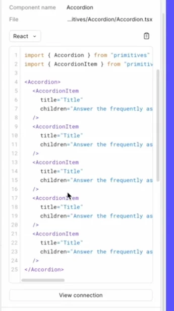

What I expect to see (this comes from https://youtu.be/s7BZz03icnY?t=244)
Notice the “React” dropdown with React component code.
What am I missing?

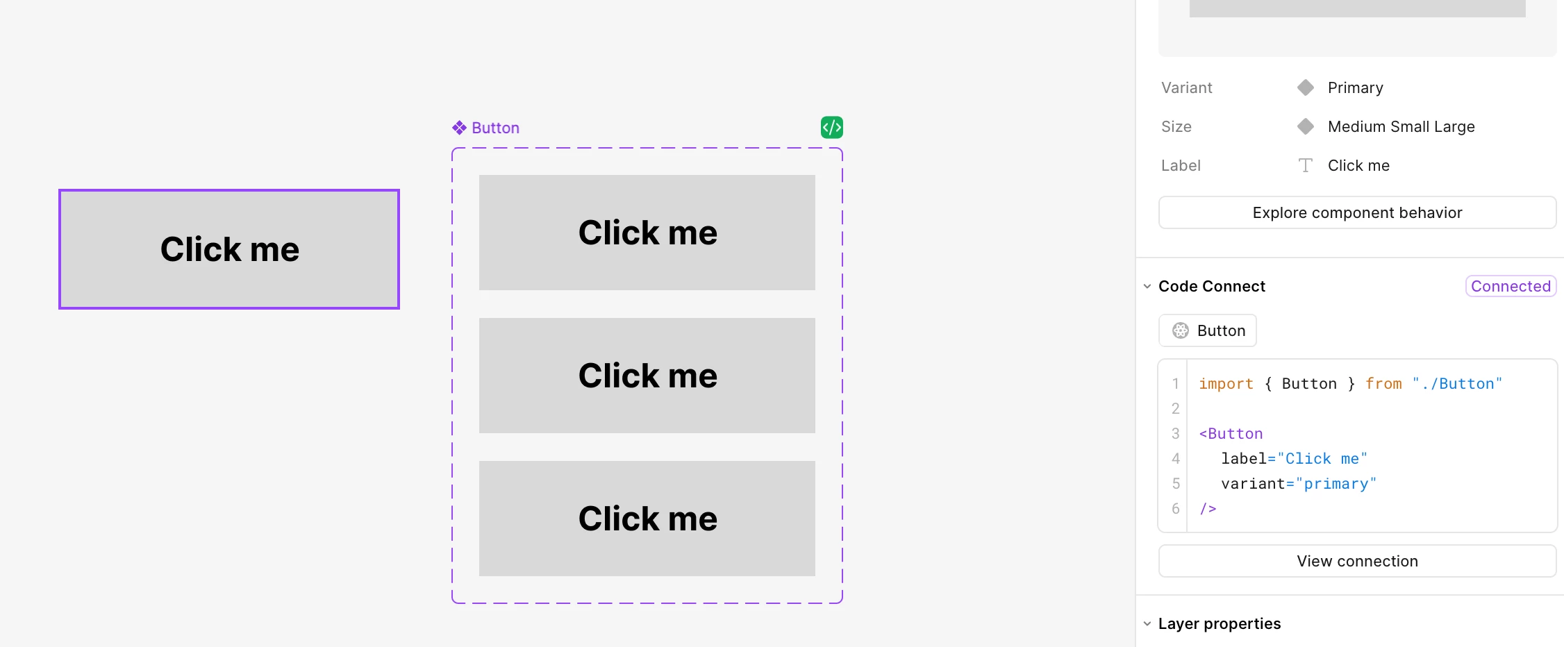

  • Back in Figma Design > toggled Dev Mode > dragged a Button instance onto the canvas > clicked it
  • The Code Connect panel showed "Connected" and rendered  the <Button label="Click me" variant="primary" /> snippet ✅
