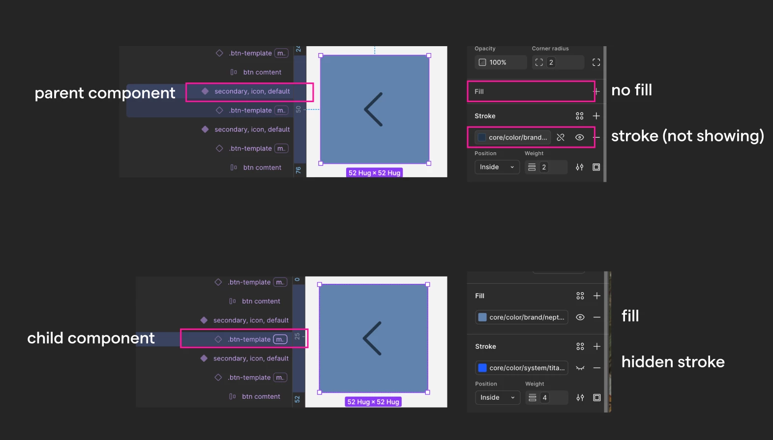

When a parent component has a stroke set to inside, and no fill,
and I add a fill to the child component, the fill now overrides the stroke, even though the stroke is placed on a layer “above” the fill. it makes zero sense.
