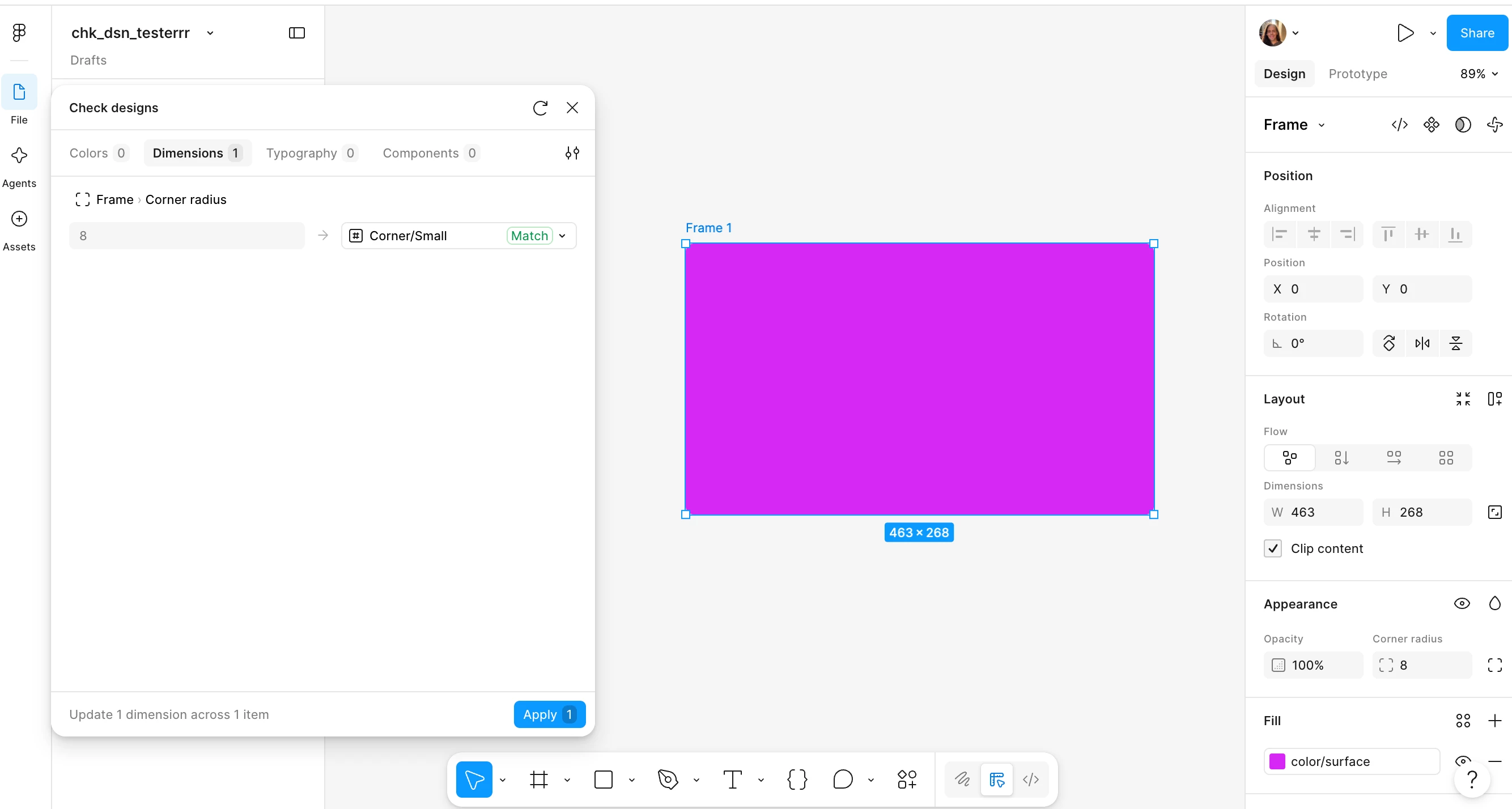

Hey hey ​@Linh-Dan Thanks for the detailed steps! I tried to reproduce this on a minimal test case and wasn't able to. In my test, Check designs correctly flagged the raw corner radius for me. I’d like narrow down what's different in your setup.
My test:
  • a single frame with a tokenized fill (clean) and corner radius set to a raw `8`
  • I created a local number variable `Corner/Small` = `8`, scoped to corner radius
  • Running Check designs, the raw `8` showed up under the Dimensions tab with `Corner/Small` offered as a Match
  • It's behaving as expected

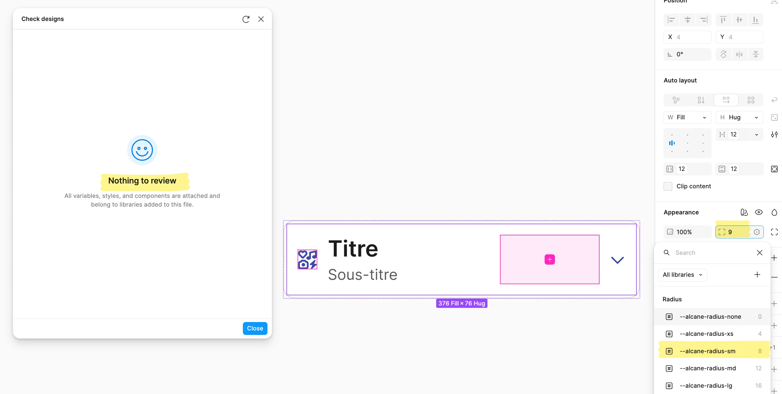

Linh-Dan
Linh-DanAuthor
Jun 18, 2026 6:07 PM UTC
Hello ​@Jaycee Lewis
Thanks so much for getting back to me so quickly! Answers below.
1. Is your radius token scoped to corner radius?
Yes, the radius variables are scoped to corner radius. They appear as candidates when bound manually, so scoping isn't the issue.
2. Does the token's value exactly match the raw value you used?
No, the raw value is 9 and there's no token at 9, the nearest one is 8.
3. Where does the radius variable live?
It's local to the file, not in an external library.
And you’re right, I can't reproduce it consistently...
Here a screen capture:

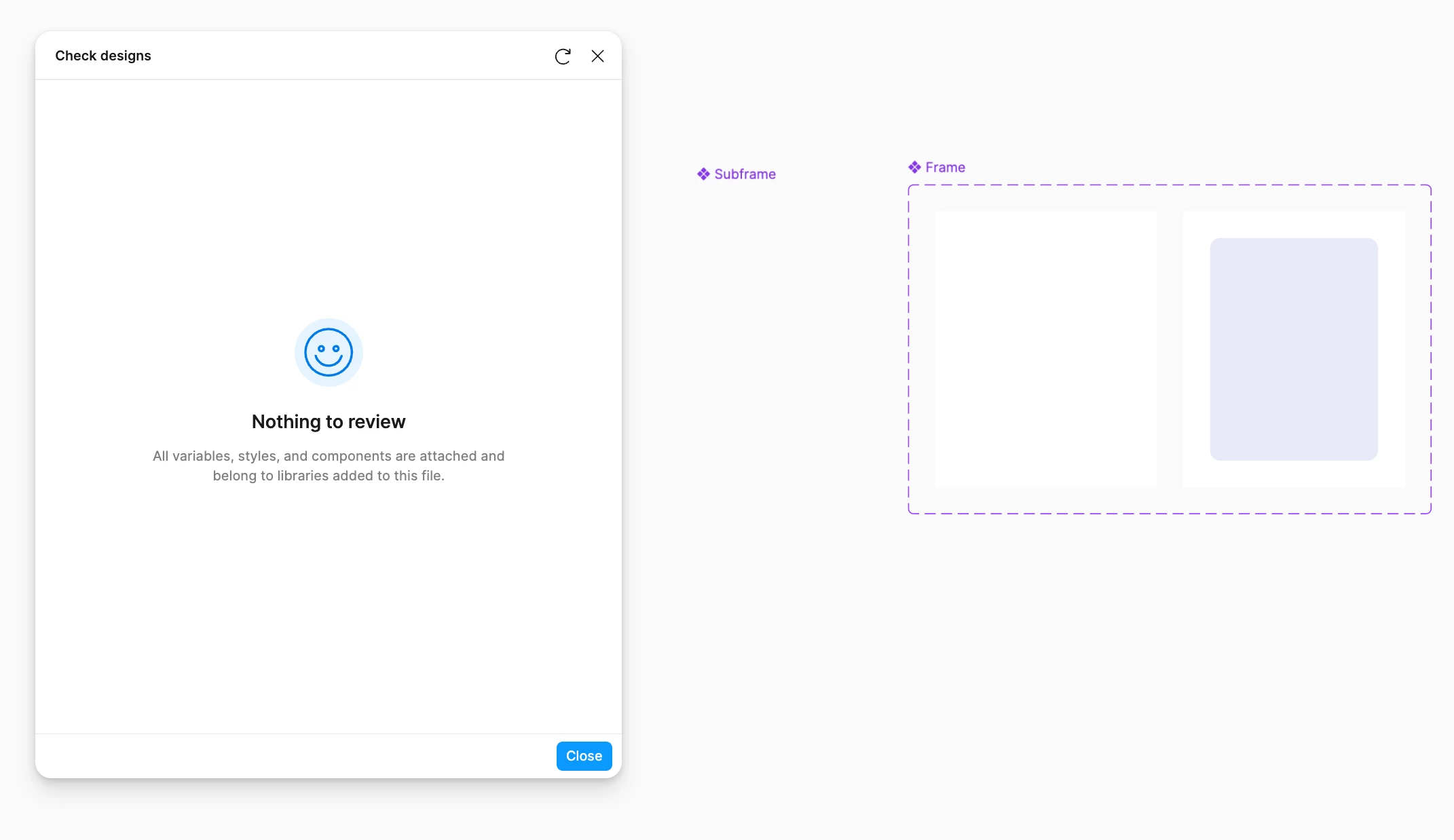

Linh-Dan
Linh-DanAuthor
Jun 18, 2026 6:39 PM UTC
Steps to reproduce:
I create a subframe (this is the accordion-header case) with a corner radius of 9px and a hidden background fill meant for the hover state. "Check designs" reports no problem. I make the background fill visible, and "Check designs" now detects the raw value. I leave it uncorrected.
I then place this subframe inside another frame (the accordion-item case). I build the default and hover variants. I run "Check designs", and it doesn't detect the raw radius, even though there's a visible background fill on the hover variant.
Here's a very simplified example (run "Check designs" on "Frame" component here):

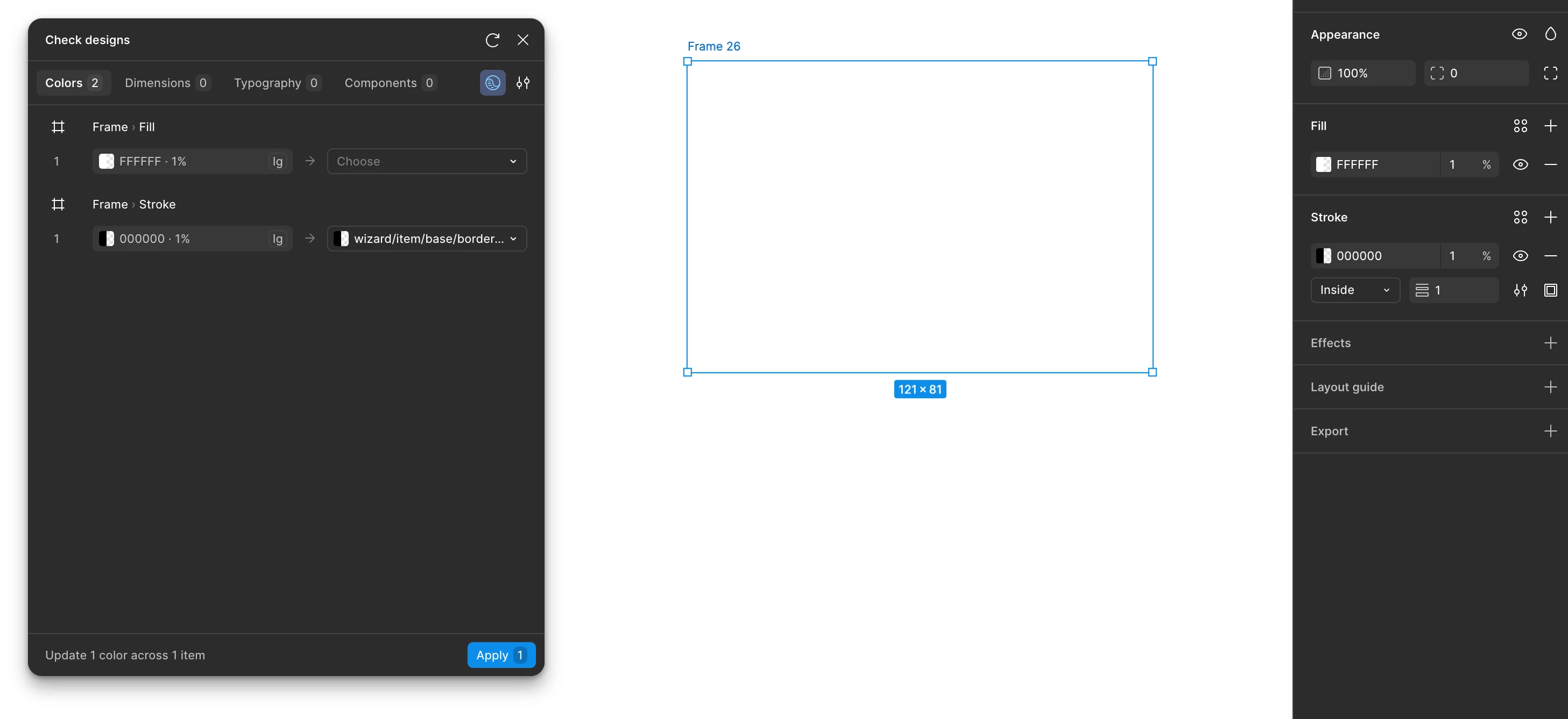

I also have the same issue with radius passing, too:
Similar to this, it marks it as a pass when the raw colour’s opacity is 0%. But as soon as you set it to 1% or higher, it shows up, even suggesting a token that’s 0% opacity:

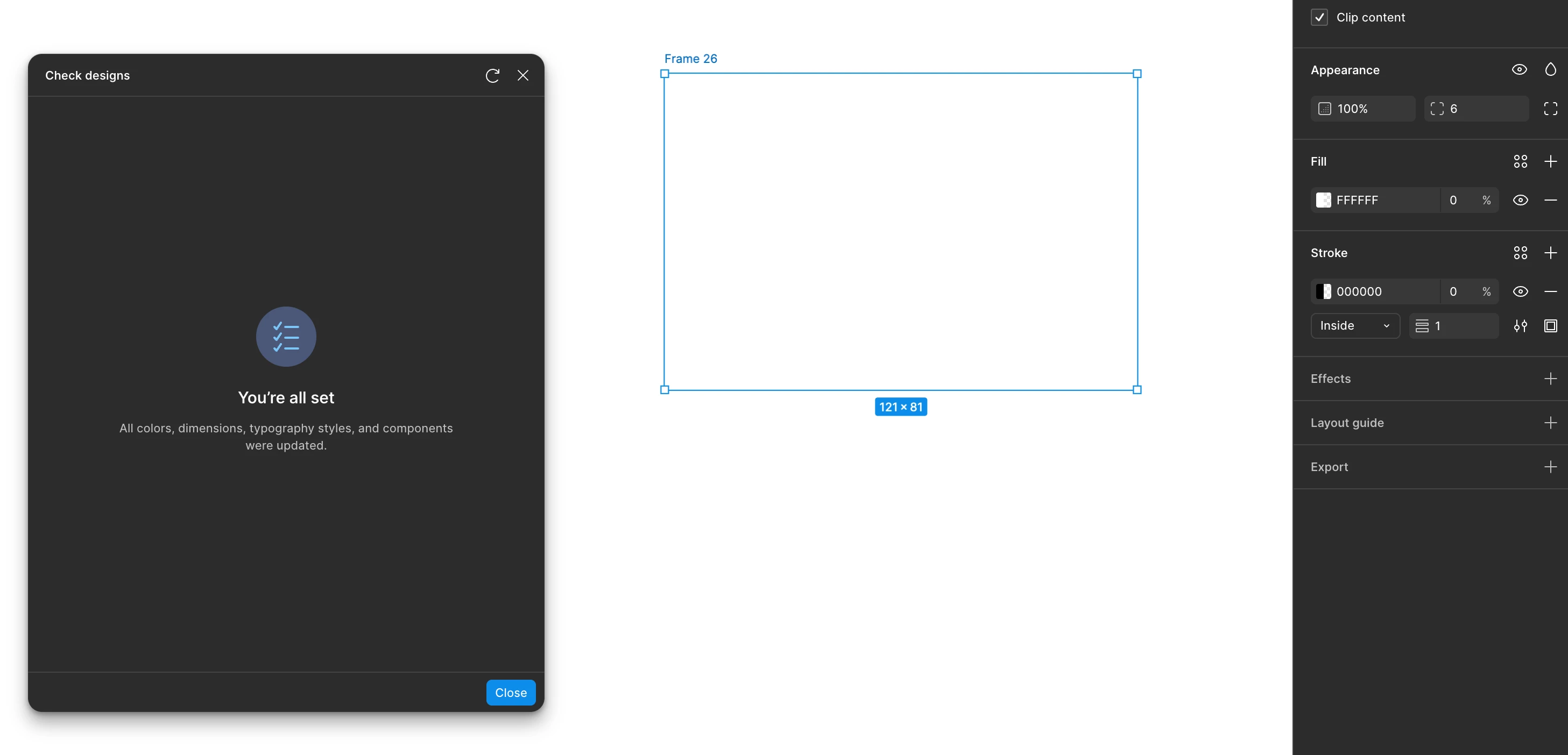

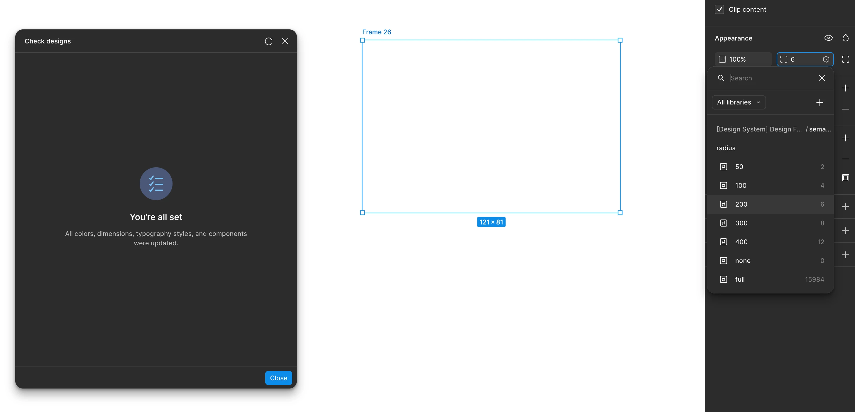

Damian_Summersall
Jul 2, 2026 10:13 AM UTC

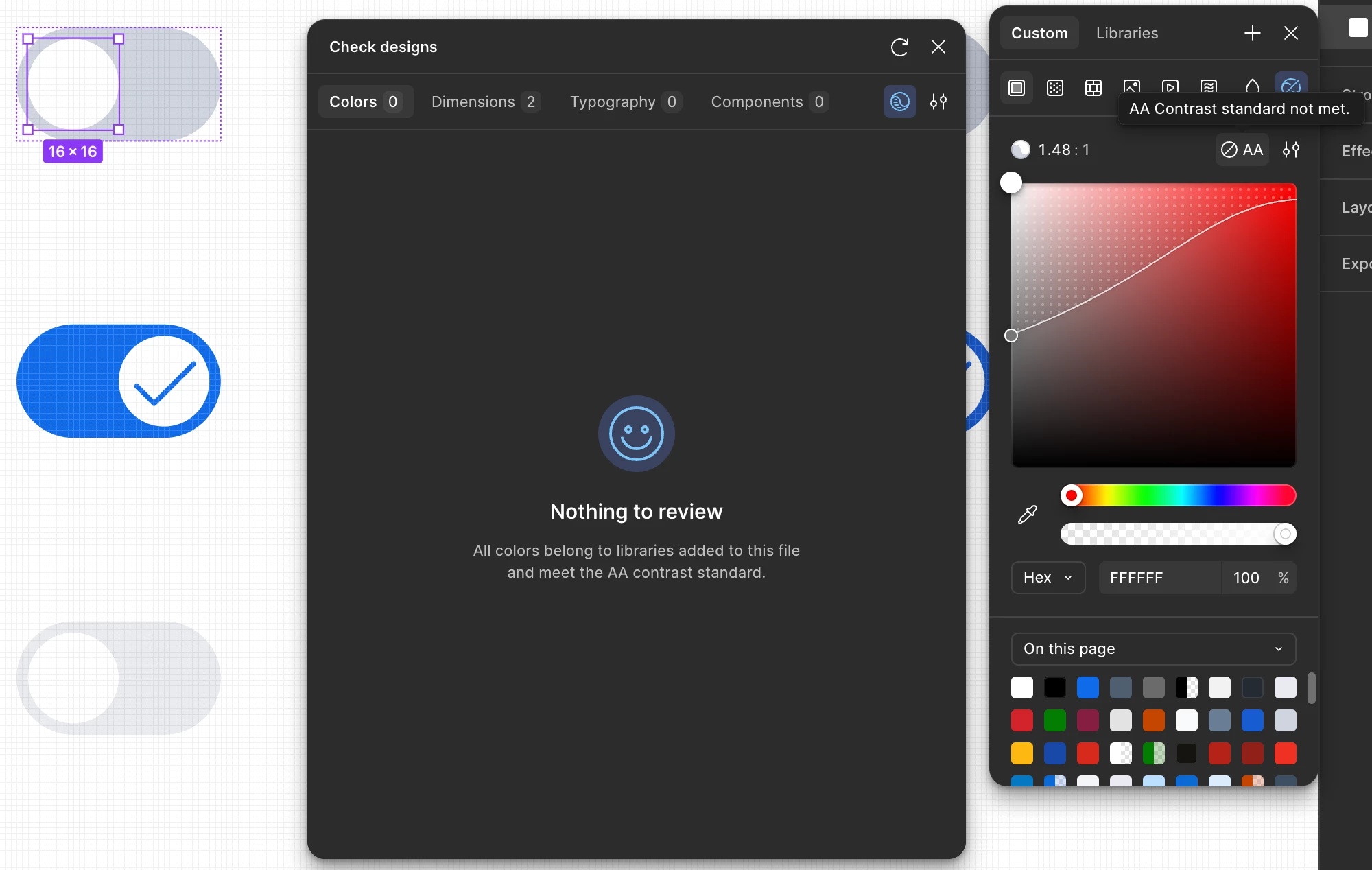

To add to this, it’s also not showing the colour contrast fails for variables (either the foreground layers or background layers that fail).

Hey ​@Damian_Summersall 👋 You’re a legend. Two more quick questions:
  • Are the flagged foreground/background colors bound to variables, or raw hex?
  • Is the failing layer on a non-default variant (like the accordion hover case), or a flat single-state frame?
Talk soon! — Jaycee
Damian_Summersall
Jul 3, 2026 7:46 AM UTC
Hey Jaycee,
  • Both bound to variables, when they’re changed to raw hex, they show up as suggestions to bind to variables.
  • It’s on the default and hover states. The screenshot shows the default state.

Hey ​@Damian_Summersall 👋 Thanks again. Here’s the support ticket ID 2000306. The ticket subject line is Check designs skips flags at 0% opacity and omits AA contrast fails for variable-bound colors. Keep an eye on your email inbox for the initial reply from me and any follow-ups from support. Thank you! – Jaycee
