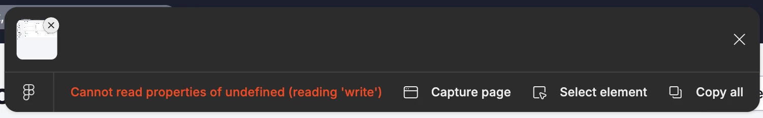

Cannot read properties of undefined (reading 'write')
I’m using the official Figma browser plugin which works great. But when I try to screenshot our local dev environment, I get this error.
It’s probably something in our local environment, but how can I debug this? When I deploy my local environment to production, it works flawless.
error message
Would love to hear if other people have the same issue and if anybody knows a solution. ​

Hey hey ​@Sythe 👋 Thanks for the great debugging question. I wonder if this a secure-context issue rather than anything wrong with your local build.
Quick way to confirm:
  • open DevTools on the failing tab
  • run this in the console 👇
window.isSecureContext
  • If it returns false, that's a useful clue
Question – How are you serving your local environment? If it's http:// on something other than localhost, a few options:
  • Access it via http://localhost or http://127.0.0.1 (both count as secure even over http)
  • Serve local dev over HTTPS (mkcert makes this painless)
If you're already on localhost and still hitting this, let me know we'll dig in. – Jaycee
Sythe
SytheAuthor
Jul 27, 2026 1:39 PM UTC
Ah that helps. It’s a local domain (for example test-docker.test:[portnumber]). We serve it over http.
Sythe
SytheAuthorSolution
Jul 27, 2026 1:44 PM UTC
I fixed it by changing .test to .localhost ;)
Jaycee Lewis
Jul 27, 2026 3:29 PM UTC
Amazing! Thanks for letting us know 🙌 — Jaycee
