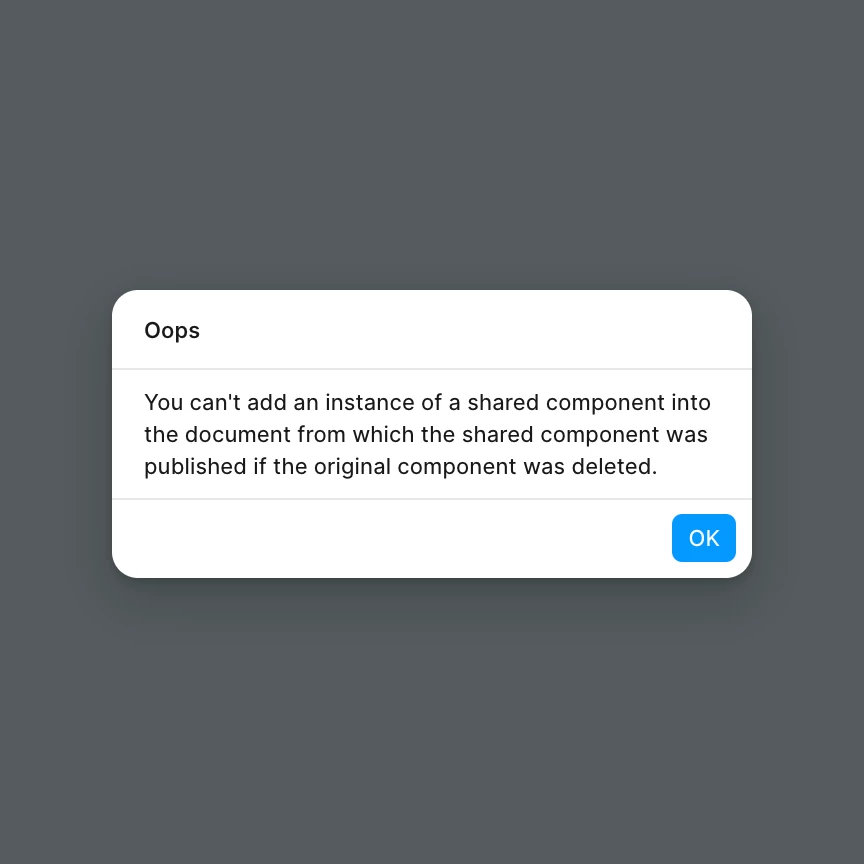

Here is the weird...the other two buttons throw this bonzo error.
“You can't add an instance of a shared component into the document from which the shared component was published if the original component was deleted.”
Someone explain that one.

Weird.
I restored the ONE restorable component.
It brought back the deleted component set but it positioned it right on top of the newer one...so, difficult to even know it was there.
Once I caught that, I republished.
Then deleted the restored component. And published again.
Now all of the ghost components are gone from the library.
HOWEVER, in the asset list, the component is named ButtonGOOD because that was how I renamed the good one of course. But the group has been renamed to Button...but Figma has it showing different. A ghost name? Clearing the cache is useless.
So I dunno Figma.
In the end...I published AGAIN and the issue went away.
Why does publishing do mre than clearing cache? Seems a bit more problematic and just pushing errors forward. But that seems to be Figma’s thing.
