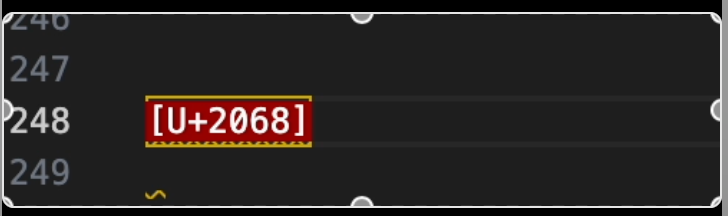

Cannot copy one line of CSS in Firefox Dev - returns unicode token

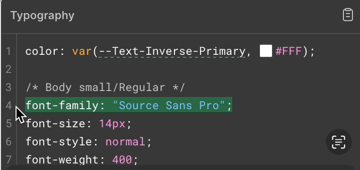

I can no longer copy one line of CSS out of dev view.
I now have to use the clipboard icon to copy all the CSS and paste it into my file, then delete what I don’t need.
I have added stills showing basics.
I am on a Mac Sequoia 15.3.1, using Figma in Firefox Dev 139.0b5. It seems to be ok in Chrome, but that is irrelevant, unfortunately, as process is dependent on Firefox Dev.

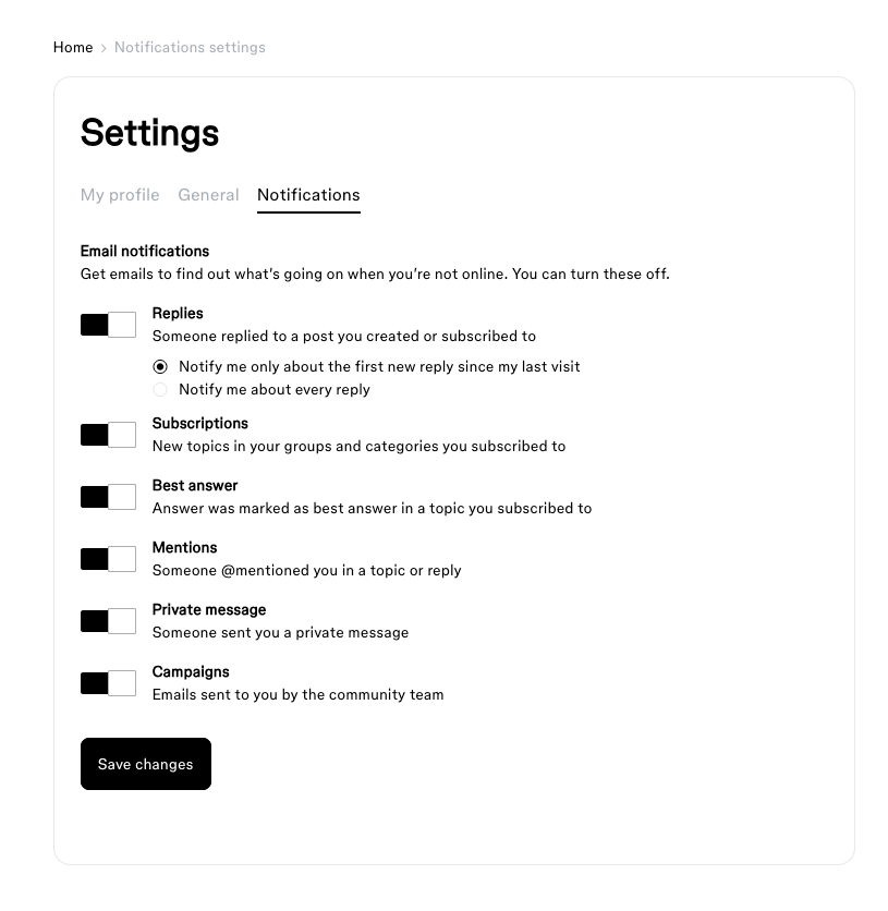

    Also - do you know how I can get alerts to this thread? I’ve only received the first notice when Samuel Patro replied...

    re: alerts -- on your first message that started the topic, do you have the ‘subscribe’ option available and selected? Just want to make sure - did you get an email alert when Samuel responded, but not me when I did?

    I see “Unsubscribe” on my original message, so that should mean I am subscribed. I did get an alert when Samuel replied, but not on any other except this one.

    ​@J.S Goooot it! Can you go click your profile image at the top right of the page > settings > notifications and then check to see what preferences you have set?
    I think you may have the “Notify me only about the first new reply since my last visit” checked. You can switch it to “Notify me about every reply” and that should get all replies sent to you via email.
    Let me know if you do have that option already selected.

    And you are correct - I changes that option in my settings - thank you!
