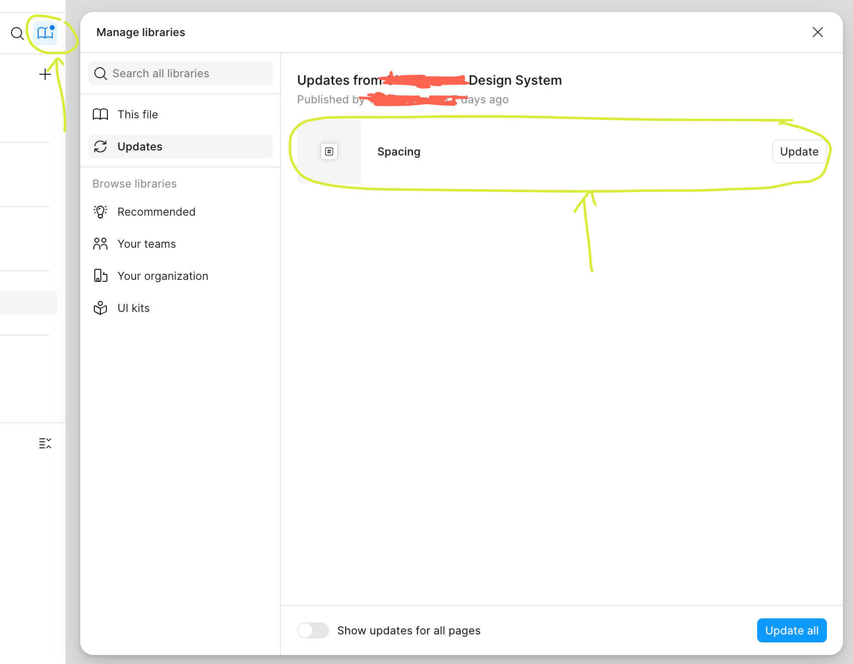

I have a persistent issue that is driving me bonkers.  I have a design system (DS) doc that I include and use on all of our design files.  I recently updated some of the variables and re-published the document.  I then ran the update on the design file and it appeared to have updated however, one variable in particular says it still needs to be updated.  I have tried to update that single variable over and over but it never clears.  I can confirm the variable has been changed and I can use it in the design file but, as far as the system is concerned it still needs to be updated.  I have tried the following to clear it:
  • Shut down Figma and restart
  • Re-edit the variable and publish/update again
  • Clear Figma cache (desktop)
When I cleared the cache the issue was gone for a short bit of time but returned and I can’t clear it again.  I have included a screenshot of the variable in the update screen:
Please help me resolve this as it is super distracting and frustrating.
I should also note that if I select all my components created in the file and delete them, the problem goes away.  If I copy those components to another file, the problem appears in the alternate document.  I cannot identify a single component that is causing the issue though.

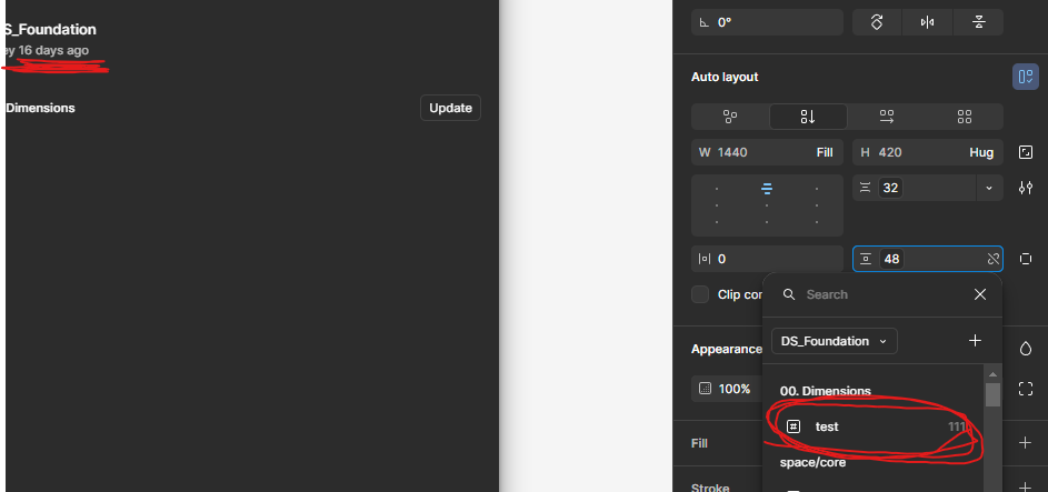

Same problem here and it starts around 10 hrs ago. and also figma tries to update 16 days ago state despite library was updated few minutes ago. Also if i press update, figma show message about success, and removes updates, but then again shows it.
  • Just made new variable (test in image)  in library. Figma somehow updated this new variable but still show notification about 16 days library update.
  • Re-resolve doesn’t help at all.
16 days ago update vs newly created variable

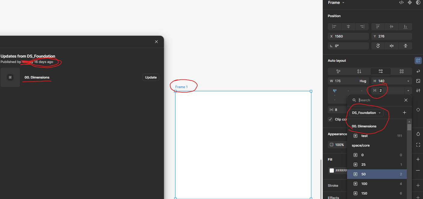

Just found a cause of the problem. This issue does’t affect library components and variables applied to them. But it affects variables applied to basic layers. But still, Figma see current library variants, as soon they applied figma show update badge for old 15 day state. When i remove variable from frame update bade disappears. Clearing cache, Relink lib, Re-resolve does’t help.
