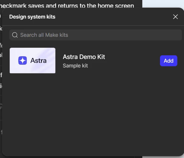

Can't use figma library in Make anymore
So with the recently release of Figma, I am not able to select my library for make. It by defaults selects a ui kit where in i don’t have a kit created.
Is there a way to select the library again like previously?

Hey ​@Junko3
I understand that, but the point is I am not able to create any UI kit through the library and neither I am able to use my library as it is.
There are some files, where I can see my library (maybe as a UI kit) but in some i can’t see that

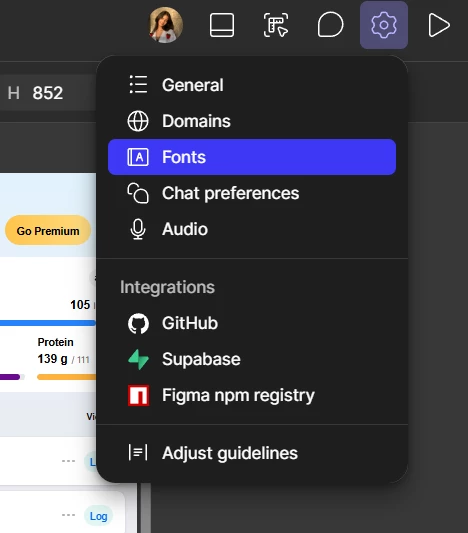

hi,
same issue, unable to create a kit the option isnt available in the settings in figma make file. attaching a screenshot. is this different for professional paid plans and organization paid plans. I currently have a professional paid plan with a full seat.
hoping for a prompt response.

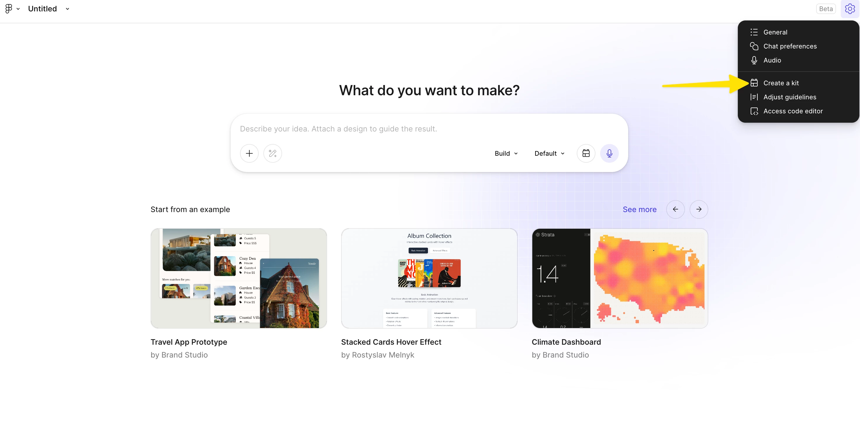

Hey, ​@Sakhi Rana 👋 Thanks for the question. That is unexpected. Can you make a quick screen recording of you:
  • Creating a fresh Make file
  • Clicking the gear icon
  • Showing the options in the dropdown
Using a fresh Make file on a Mac using the desktop app, this is what I see:
Thanks for the additional details! — Jaycee

Hey ​@Edep_NL, thanks for reaching out!
A couple of things could explain what you're seeing:
  • The Make file already has prompts or edits in it. Create a kit only appears in a file that's still completely untouched, once you start building, that option drops out of Settings.
  • If you're a guest on an Organization account, guests currently can't create Make Kits regardless of seat type, only full members can.
If it's the first one, here's how to get a kit set up with your design system:
  1. Open a brand new Make file (don't prompt or edit anything in it yet).
  2. Click the Settings icon in the top-right corner and select Create a kit.
  3. Choose Assemble your kit, then select your published Figma Design library from the list — make sure it's published and contains styles or variables.
  4. Click Add selected, then publish the kit.
Once it's published, you can select it in any Make project going forward. If you've already got work built out in your original file, you can bring it over by downloading the code from there and uploading it into the new kit-enabled file.
