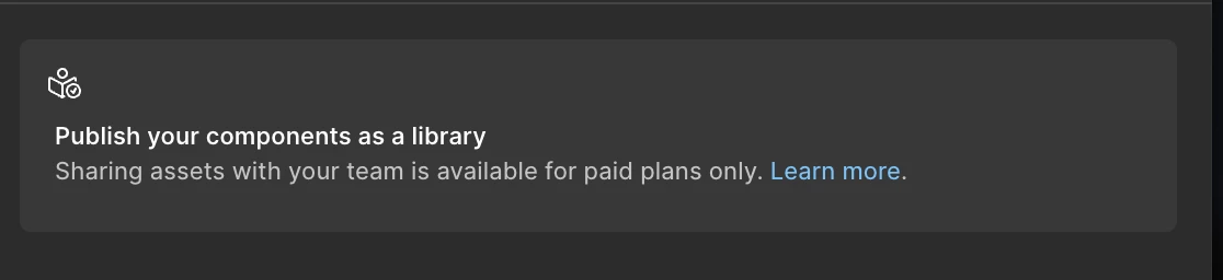

I have a paid plan and my client has a paid plan. We have two files with the design system and design pages. I usually change components, publish the design system library, and work with these components in the design pages files. But now I can't publish it. Is it a new update or something? I'm invited as an external editor to the client's Figma, and today we tried to invite only me as an editor to his Figma. And it's still not working, even though the client paid for my full seat.

I figured this out, so yes, I was the editor of the whole project, and I had a full seat. And only one thing helped me publish a library: that's when the client gave me admin rights to his whole team. And it's so weird on so many levels. First, why doesn't Figma just write that on this screenshot and tell me this stuff about a paid user, how I shod to figure out this?
Second, why if I don't want to give a some random freelancer whole admin rights to my Figma, and I just want him to work with the design system and one file? And it worked previously, so it's really weird I think
