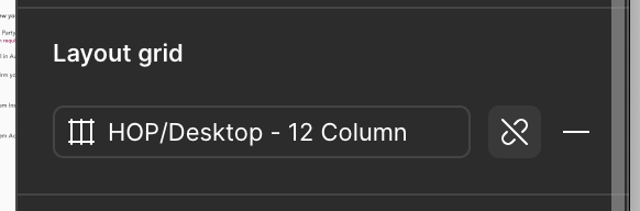

Can't hide grid. Icon button missing.
Icon button to hide grid style is missing on hover. Grids are visible. They cannot be turned off from any frame including local components.

That’s how it’s supposed to be now.
The team recently implemented a change, so this is now expected for grid styles. The Hide icon will not be visible if you have a grid style applied. You will now need to Detach style first in order to see the option to Hide.
