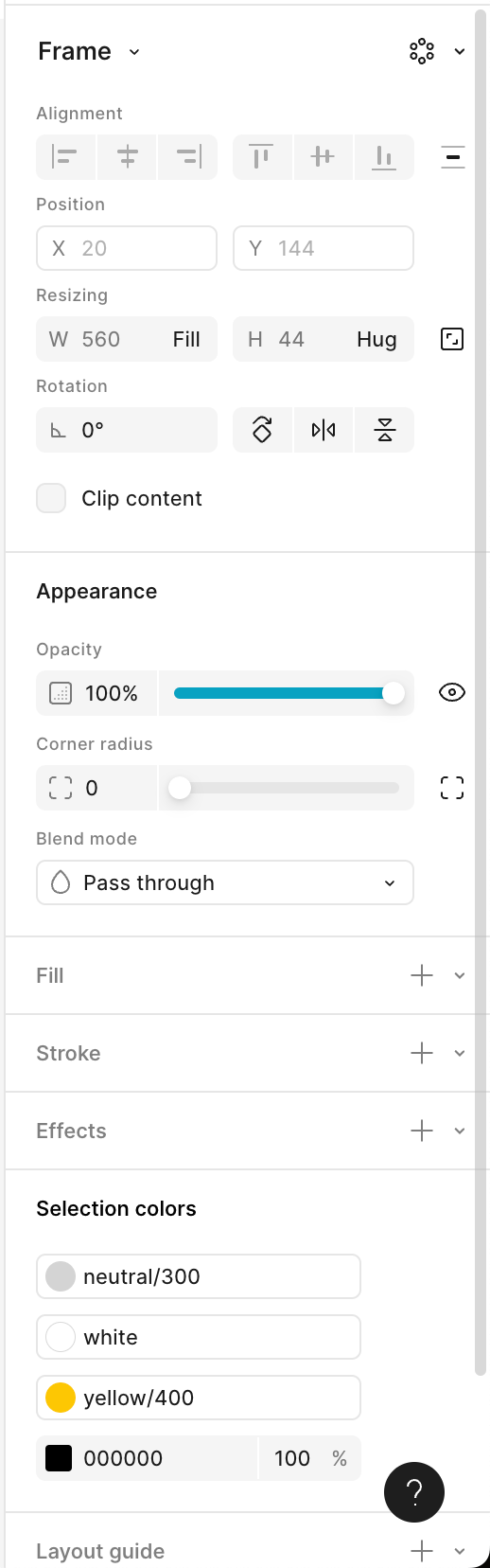

can't find auto layout secion on the right section
I can’t find layout after the update.
I used to see one when I created a frame with shift + a .
    Ondrej_Pavlicek
    Figma Ambassador
    Figma Ambassador
    May 10, 2025 8:21 AM UTC
    Hi there! 😊
    If you can't find Auto Layout after the update, I think it's because you're in Figma Draw mode, which is a new mode recently introduced by Figma. It’s possible you were switched to it automatically.
    Solution:
    Switch to Figma Design mode, and you should see the Auto Layout options again.
    Hope this helps!
