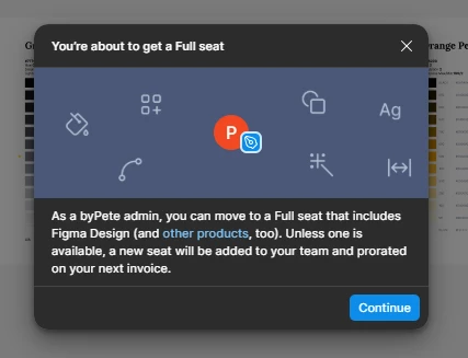

Can no longer access figma plugins
I am using a professional plan but have suddenly lost access to plugins. They are now blocked by a popup that wants to convert the account to a full seat.
I updated Figma this morning but the issue remains.
All plugins are triggering this popup when selected.
Would appreciate any help to resolve this bug as I’m unable to export variables which is a big issue for development.
Clicking Actions and then selecting a plugin
The plugin is blocked with this popup and there is no option to just use the plugin

Thanks for following up on this. The popup appeared because some plugins require a specific seat type to run. In your case, the plugin you clicked on requires a ‘Full seat’, so the CTA prompted you to “continue,” which unintentionally upgraded your seat so the feature could load. (Please note, not all plugins require a Full seat -- it depends on the plugin).

Thank you ​@Celine_ for the prompt reply - the popup has caused the subscription issues by forcing it to full seat when clicking continue - any idea why it is there in the first place?

Hey @AB, could you double-check whether you’re on a Full seat rather than a Collab seat?
Just to clarify the issue here: some plugins require a Full seat because they need edit access in Figma Design files. That’s why you saw the prompt asking you to upgrade to a Full seat. With a Collab seat, you can view and comment access in Figma Design files, but you won’t have edit permissions (and certain plugins depend on that).
