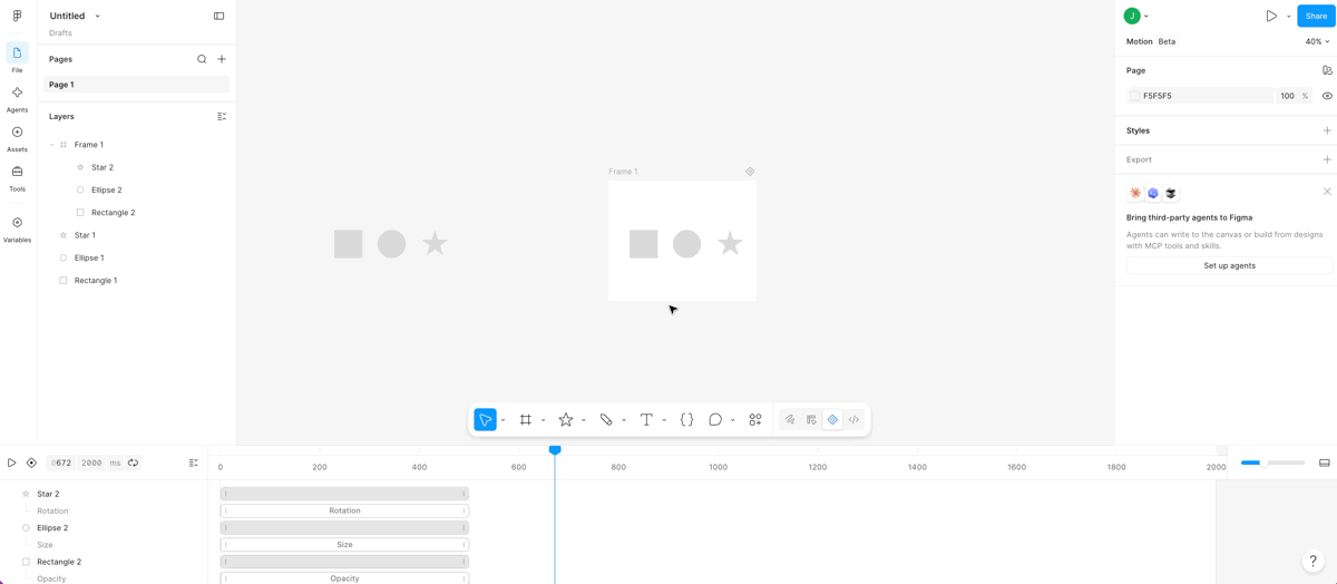

Jaycee Lewis
Jul 22, 2026 10:29 PM UTC
Hey hey ​@Paulo_Matsui 👋  Thanks for the details.
  • I set up a test file with two groups of shapes — one set of loose top-level layers, and one set nested inside a frame
  • Added a preset animation to each
  • Ran through all four selection methods on both groups: Select All (⌘A), marquee, marquee + modifier key, and Shift-click
In every case the layers stayed selected and moved together as a unit when I dragged. I couldn't reproduce the selection breaking. I've attached a GIF showing each variation so you can see exactly what I tested
A few details would help us dig in:
- A full-screen recording (not zoomed in) showing the issue happening, so we can see the full context
- Whether the layers you're selecting are nested inside a frame/group or sitting at the top level
- Your OS and whether you're on the desktop app or browser
Once we can see it in action we'll be able to narrow down what's different. Thanks again for reporting it! — Jaycee

To clarify, I actually meant in the timeline rather than on the canvas. This happens in the Motion tab when I try to move keyframes that are already set.
I attached a short video to show what’s happening. In the first two attempts, I try to lasso-selecting a group of keyframes, but the selection breaks and only one bar moves. On the third try, I Shift-click each bar individually, and then they finally move together as a group like they should.

Thanks again ​@Paulo_Matsui 🙌 I reproed using your video as a quick guide and got the same result. I took this post and your example video to the team. I’ll follow up if I get an update for us. — Jaycee

Hey, ​@Paulo_Matsui 👋 Quick follow up — does it work when you select the keyframe (not the main animation bar) to move the layers? Thanks! — Jaycee
Paulo_Matsui
Jul 28, 2026 1:10 PM UTC
Yes. Holding and dragging any keyframe does the trick.
Meaning, I can select multiple timelines, and drag them around by holding one of the keyframes
Thank you!
