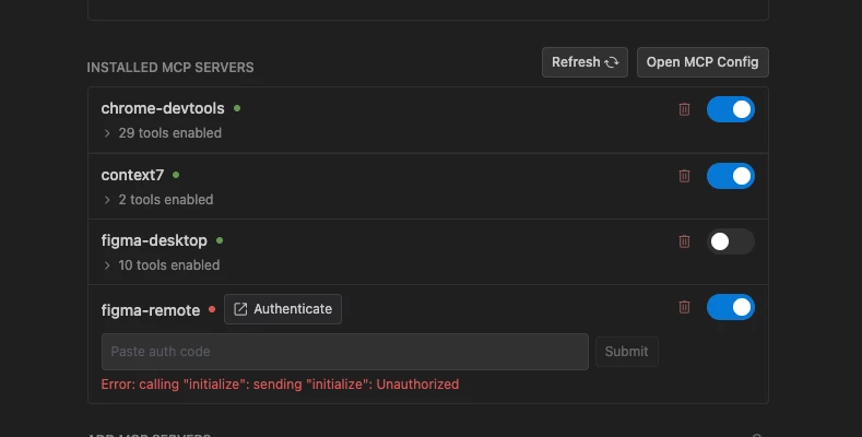

I have same problem in antigravity IDE, when i run oAuth, it falls to the same error message. Here is my MCP config.
"mcpServers": {
"chrome-devtools": {
"command": "npx",
"args": [
"-y",
"chrome-devtools-mcp@latest"
"context7": {
"serverUrl": "https://mcp.context7.com/mcp"
"figma-desktop": {
"serverUrl": "http://127.0.0.1:3845/mcp",
"disabled": true
"figma-remote": {
"serverUrl": "https://mcp.figma.com/mcp"
