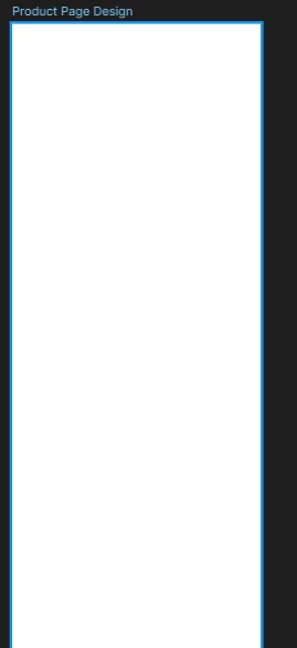

Issue Description: I am experiencing a consistent issue with the "Copy Design" button in Figma Make. After generating a design, clicking "Copy Design" and pasting it into the Figma canvas frequently results in a blank frame.
Details:
  • Reproducibility: Highly consistent (nearly 100% reproduction rate).
  • Success Rate: Only about 1 out of 20 attempts successfully pastes the design. The rest all result in empty frames.
  • Actual Result: An empty frame is pasted without any layers or content.
  • Expected Result: The complete generated design should be pasted into the Figma file.

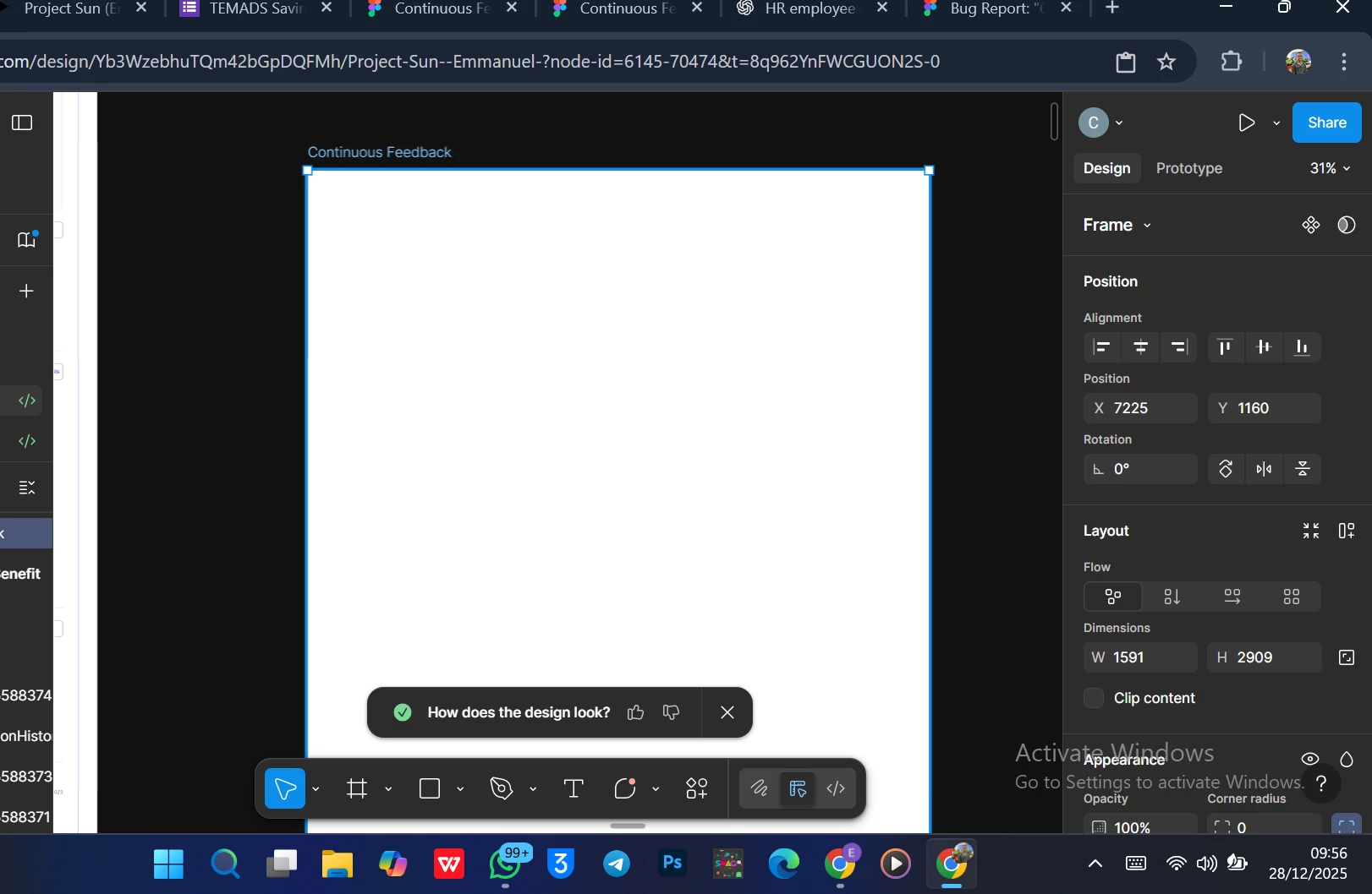

i am also currently going through the same problem, the older generated versions of the design appears as a blank or empty frame when copied to figma canvas. pls i need help on this

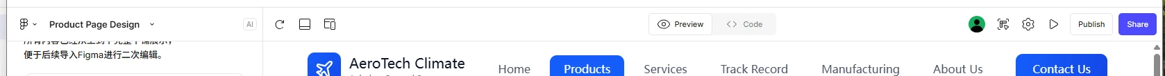

"The issue is not caused by elements not being fully loaded when copying.
I followed the reply from another designer below—closing the file, reopening it and then using the device size property (Mobile preview). Give the desired size (desktop or mobile) and then copy the design.—and it does temporarily solve the problem.
This issue seems to affect many files; it has occurred in almost all of mine. I suggest you try generating one to test it out (try a long web page design with a lot of content)."

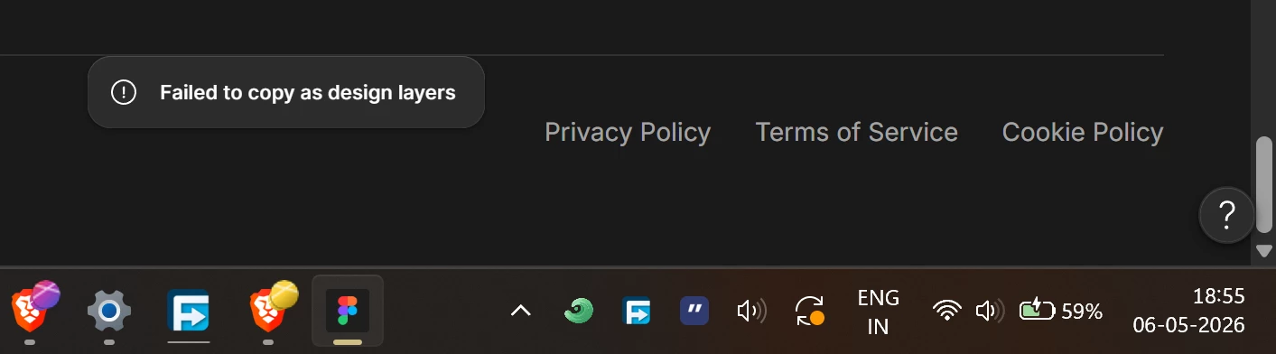

The issue is still there in May_2026 how awful from #Figma that they can show things but can’t give it to even pro users😑
adamsmasher
May 7, 2026 5:43 PM UTC
Thanks for your reply, ​@Zam_App, and for including a screenshot. It’s definitely frustrating when you can’t see why it won’t copy.
Did you try the steps ​@Salvatore Anastasia gave in a previous reply?
close the file, reopen it, and then use the device size property (Mobile preview). Give the desired size (desktop or mobile) and then copy the design.
From what I can tell, it seems like this is ensuring that the design loads in a way that ensures it copies. It’s not ideal that you’d need to do this, though every design created in Figma Make is different and maybe there’s something about your particular design that is solved by following those steps. One other thing that you can try if you continue to have issues: you can preview a previous version of a Make file, so it might be worth seeing if you can copy a previous design. To do this in Figma Make, click on the Version dropdown at the top of the chat panel on the left, then click on the “...” button for a version and click the Preview version option.
