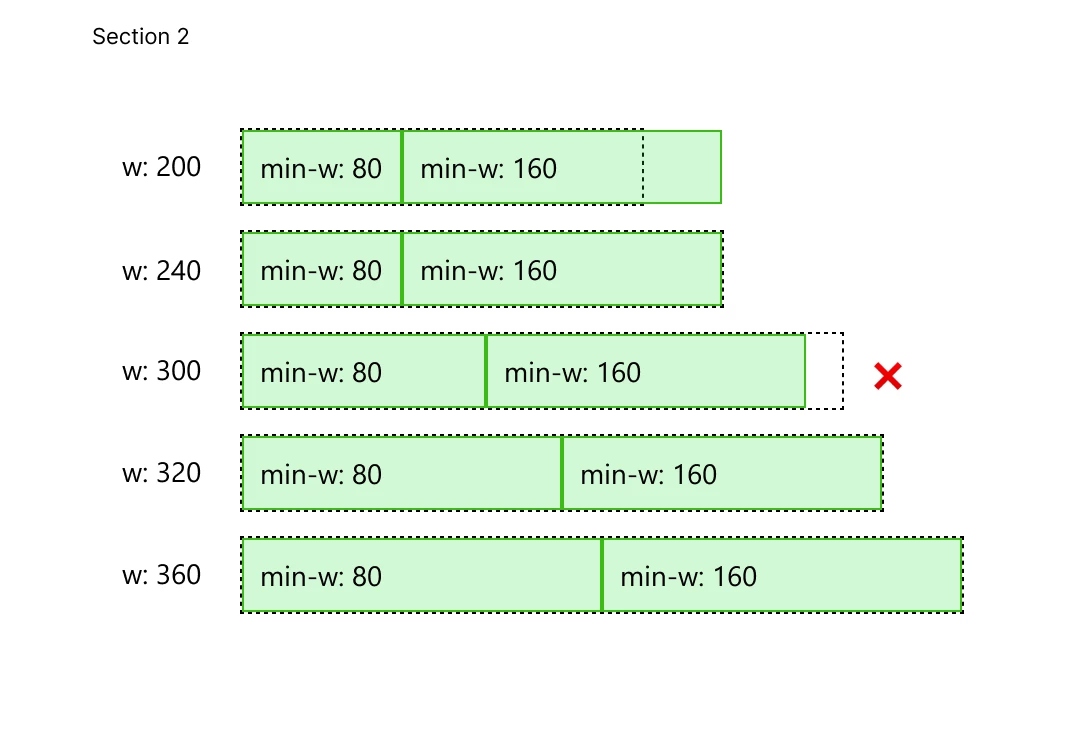

In a horizontal Auto Layout frame with two Fill children (layoutGrow: 1), when one child's min-width exceeds the equal share of available space, the layout engine fails to redistribute remaining space. The other child falls back to its content width instead of filling the remaining space, leaving an unallocated gap.
Reproduction Steps
  1. Create a horizontal Auto Layout frame (no gap, no padding)
  2. Add two child frames, both set to Fill container (layoutGrow: 1)
  3. Set child A's min-width to 80px, child B's min-width to 160px
  4. Add text content inside each child (with 8px padding)
  5. Resize the parent frame to various widths and observe

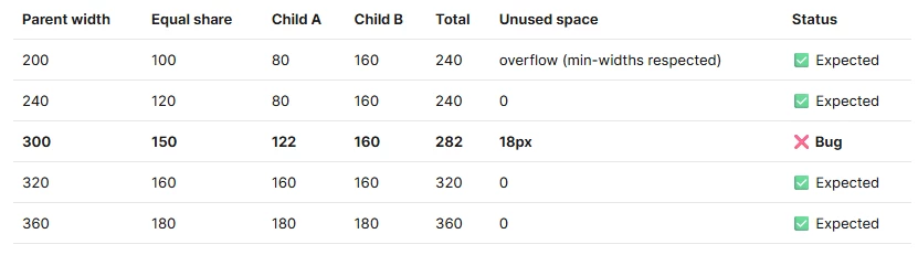

  • Child A content width: ~122px (text + padding)
Results
Analysis
The bug occurs only when the equal share falls between the two min-width values (80 < equal share < 160):
  • w: 300 → equal share = 150. Child B’s min-width of 160 exceeds the equal share (150).
  • Expected: Child B → 160px, Child A → remaining 140px (> min-width 80, so valid)
  • Actual: Child B → 160px, Child A → 122px (content width fallback), 18px unallocated
When equal share ≥ 160 (w: 320, 360), both children Fill correctly. When equal share < 80 (w: 200), both children respect min-widths and overflow as expected. The issue is isolated to the case where one child's min-width forces it above the equal share.

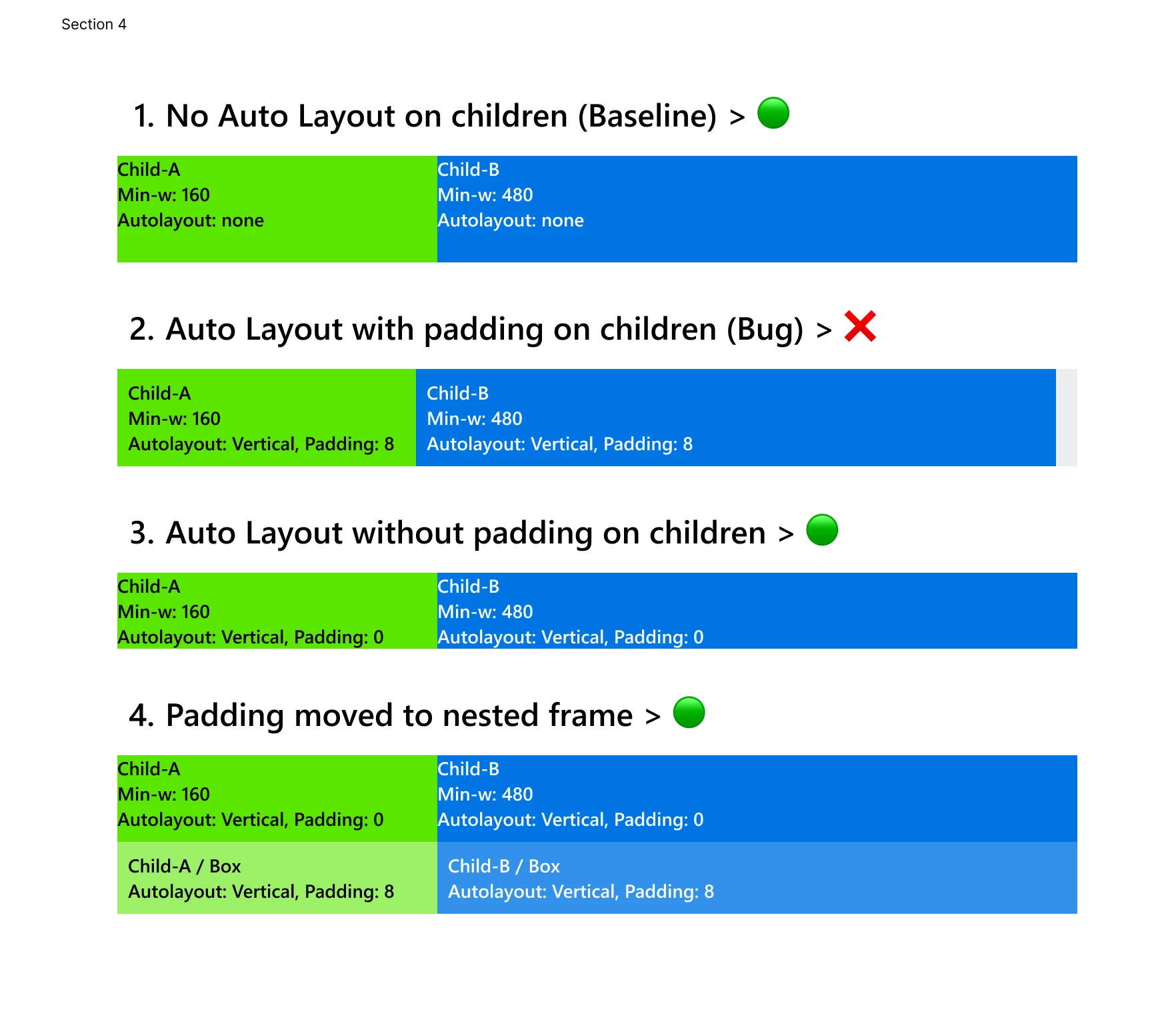

Update: I found the root cause and a workaround, but this still appears to be a layout engine bug. The issue is specifically triggered when Fill children have Auto Layout with horizontal (side) padding.
Test Setup (common across all cases)
  • Parent: Horizontal Auto Layout, width 720px, no gap, no padding
  • Child A: Fill container, layoutGrow: 1, min-width: 160
  • Child B: Fill container, layoutGrow: 1, min-width: 480
  • Equal share = 720 / 2 = 360. Child B's min-width (480) exceeds this, so expected result: Child B → 480, Child A → remaining 240.
Results
1. No Auto Layout on children (Baseline) 🟢 Child A = 240, Child B = 480. Total = 720. Fills correctly.
2. Auto Layout with padding on children ❌ Both children set to Auto Layout: Vertical, Padding: 8 (all sides). Child A = 224, Child B = 480. Total = 704. 16px unallocated. The missing 16px = Child A's left + right padding (8 + 8).
3. Auto Layout without padding on children 🟢 Both children set to Auto Layout: Vertical, Padding: 0. Child A = 240, Child B = 480. Total = 720. Fills correctly.
4. Padding moved to nested frame 🟢 Children set to Auto Layout: Vertical, Padding: 0. A nested child frame inside each has Padding: 8. Child A = 240, Child B = 480. Total = 720. Fills correctly.
Conclusion
The only variable that breaks Fill distribution is horizontal padding on the Auto Layout child itself. The layout engine appears to subtract the child's side padding from its allocated width during the Fill calculation, but fails to redistribute that space.
Workaround: Avoid setting side padding directly on Fill children that have Auto Layout. Instead, nest a child frame inside and apply padding there (Case 4).
