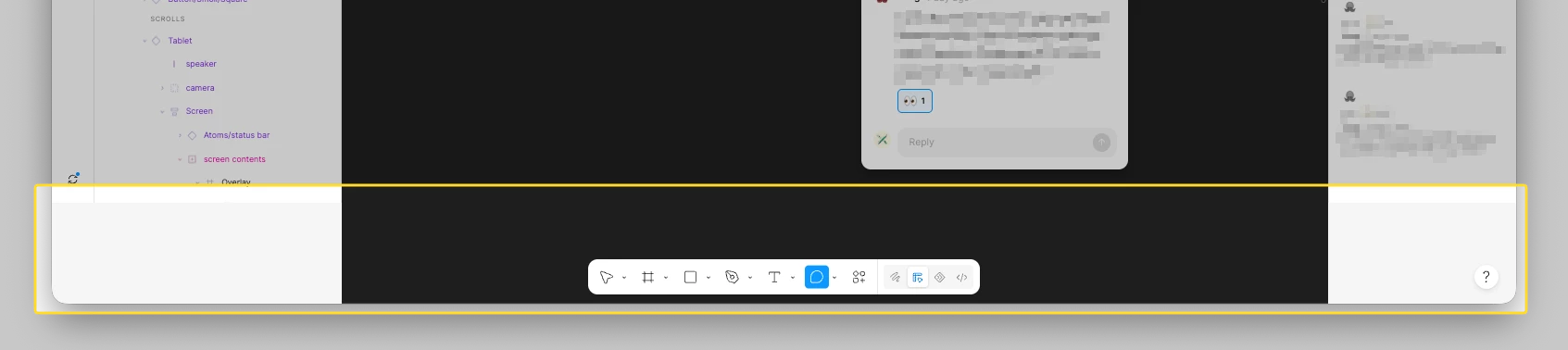

Open the comments panel and click on a comment. If the comment thread is long and doesn’t fit the vertical height of Figma window, it forces the open Figma document to scroll upwards to accommodate the full comment thread, which causes the UI to shift upwards with the top part cut off, and an empty space of equivalent height displayed at the bottom of sidebars.
The frustrating part is that the scroll is locked, so I cannot scroll back down to fix it. The only immediate fix is to reload the page.

I have the same issue, also on the Desktop app in MacOS.
I found that changing modes (from Design → Draw for example) or simply pressing the ‘?’ button in the bottom right corner resets the Main UI.
It is quite irritating to deal with.
UI shift shown in the layers and comments panel.
