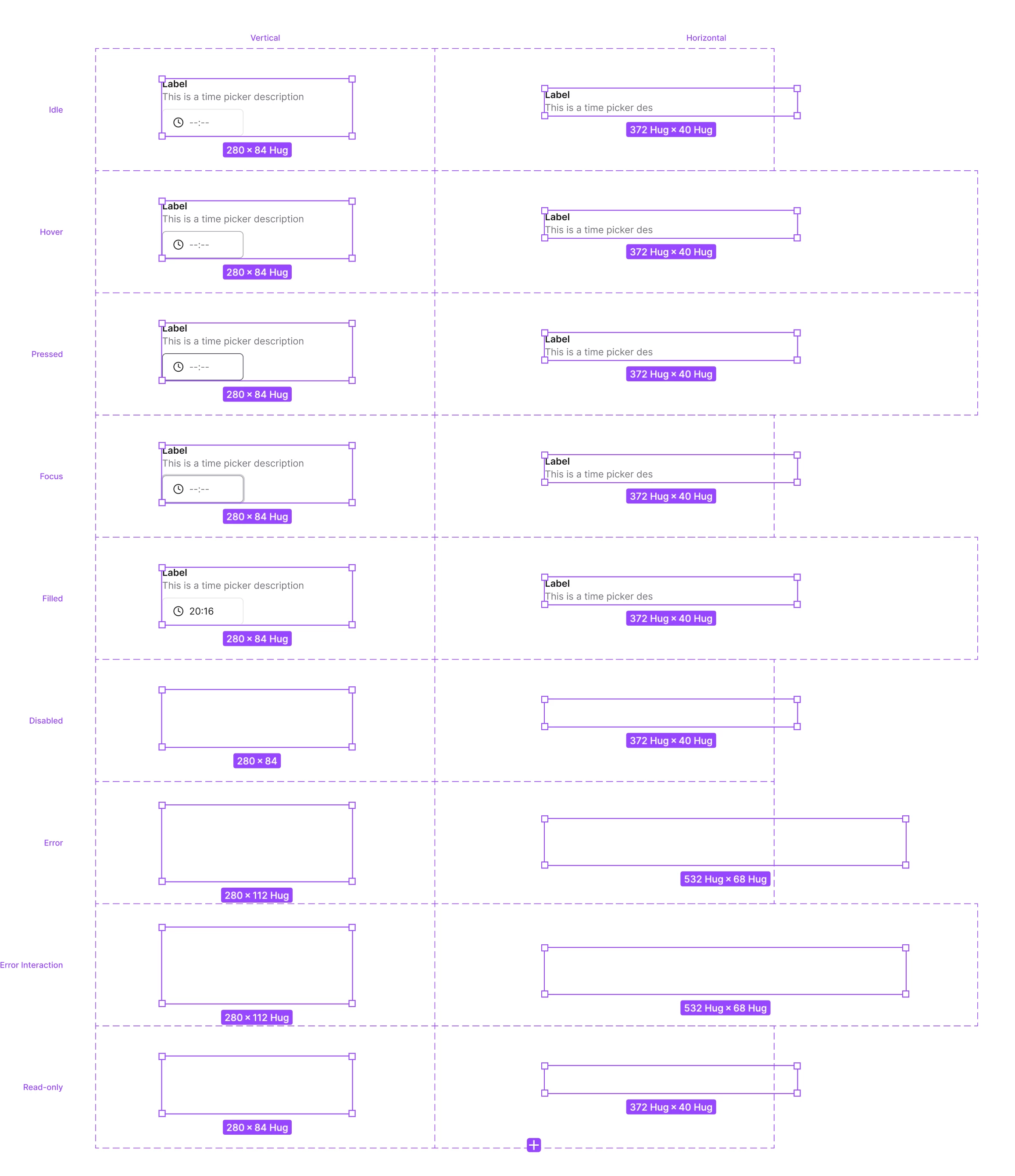

Bug: Component partially invisible in branch
Hey everyone
We’re encountering an issue in Figma where components inside a branch are only partially visible. Certain variants or sub-parts appear to be missing, while others render correctly. The same components display normally in the main file.
  • Components appear incomplete in the branch (see attached images).
  • Some states/variants are not visible and appear as empty frames.
  • For some components only part of the content is missing
  • This affects multiple variants within the same component set.
  • The issue does not occur in the main file; only in the branch.

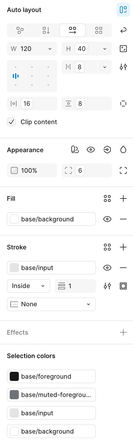

What we’ve checked / tried
  • Verified that all libraries are enabled and up to date.
  • Confirmed no missing fonts or broken image fills.
  • Checked visibility, opacity, and blend modes.

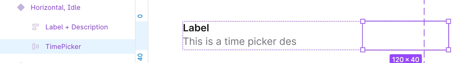

  • Components are still technically “there” (selectable), but visually absent.

Hey, just adding on here that I’m having the same problem. I can go in and manual adjust each box and then undo and it’ll correct but for large libraries it’s extra work and also easy to miss one box.
It happens when I update from the main branch and the frames in the main branch are a different size. Also happens when I merge.
