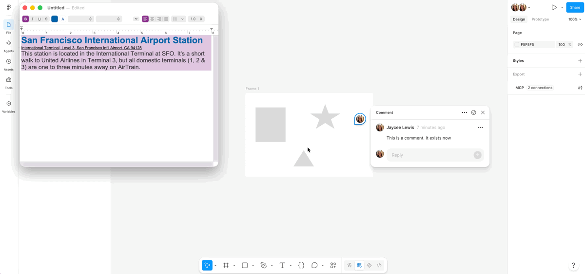

Hey ​@Kyle_Jackson 👋 The definitely sounds unexpected. Can you make a quick screen recording or gif showing the issue from start to finish, please? I tried to repro this is in a new Design file, but couldn’t get it to not paste into the comment.
MacOS, Chrome. All updated. Thanks! — Jaycee
