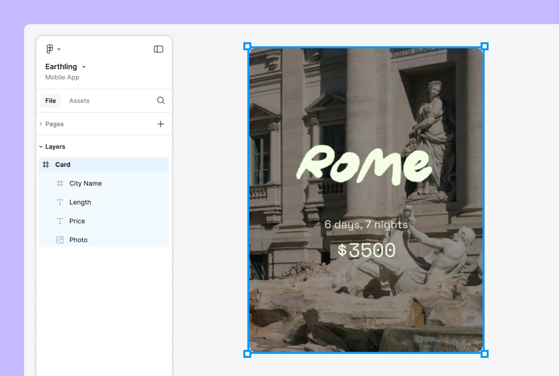

Hi ​@leorawr,
I understand you're experiencing an issue where none of the objects within your frame are appearing when you play your prototype.
Let's troubleshoot this together. First, could you please double-check your "Layers" panel on the left?
Make sure that every object you've placed in your top-level frame on the canvas is actually nested within that frame in the layers panel.
For example, in this image, the "Card” frame is the top-level frame, and all objects inside it are nested under it in the Layers panel.
If the issue persists after checking above, would you mind sharing a video or screenshot of the full Figma screen? Please also expand all layers in the Layers panel in the recording or image. This would be incredibly helpful!
Sharing it here might allow our community experts to offer assistance, or it will give us the necessary information to connect you with our team if needed.

Hi ​@leorawr,
