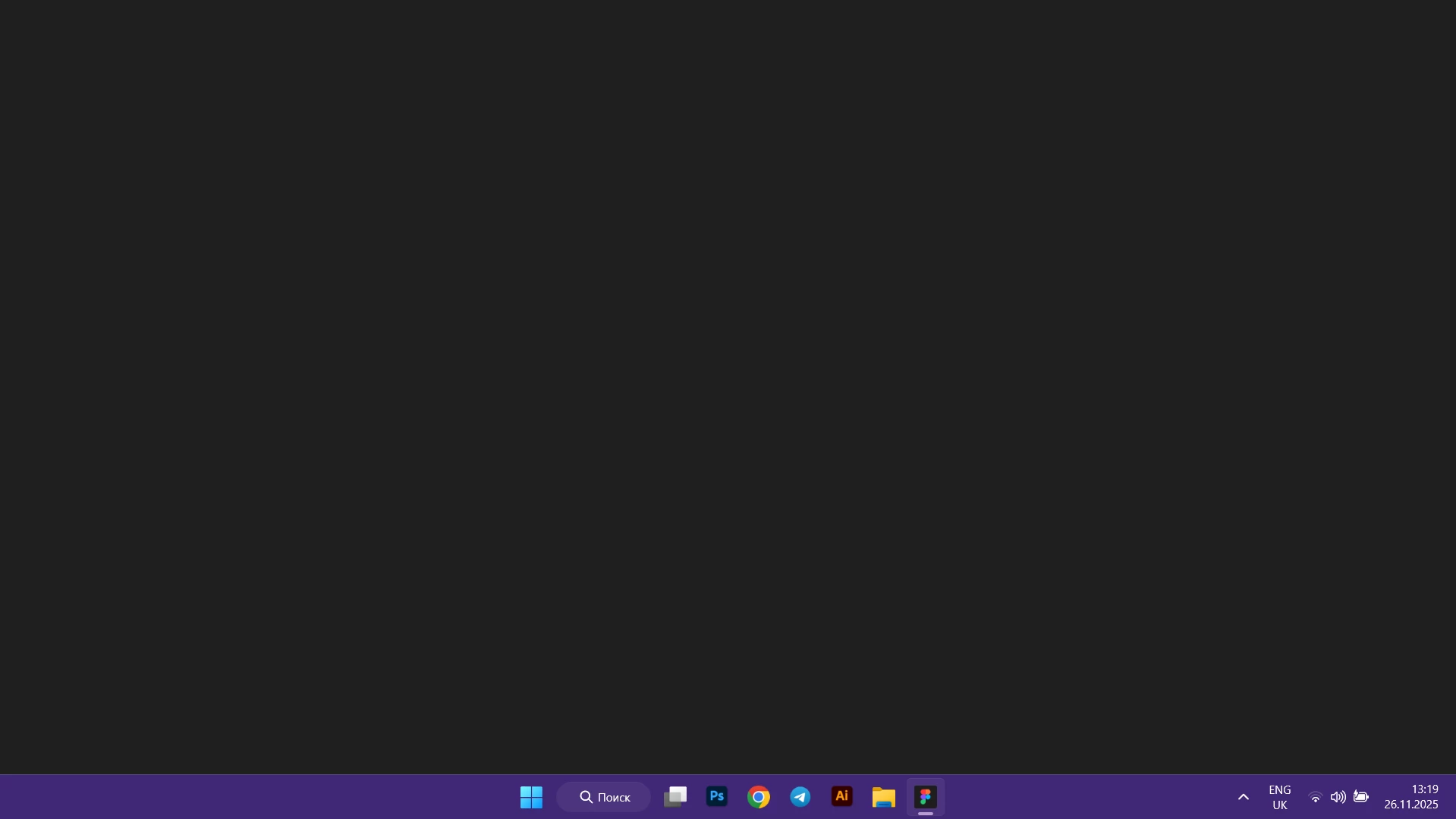

Hello! I have a black screen issue with the Figma Desktop app, even though the browser version works fine.
It has been working on this device pervectly until yesterday. I’m using the latest version of both my OS and the Figma Desktop app. Internet connection is also fine and vpn is turned off.
I’ve already tried to restart my computer, reinstall Figma, clear Figma cache. Nothing worrks. What can i do in this situation?
