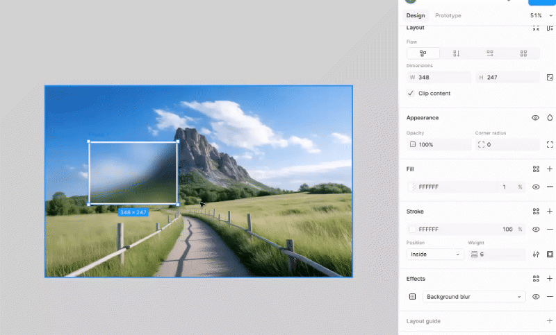

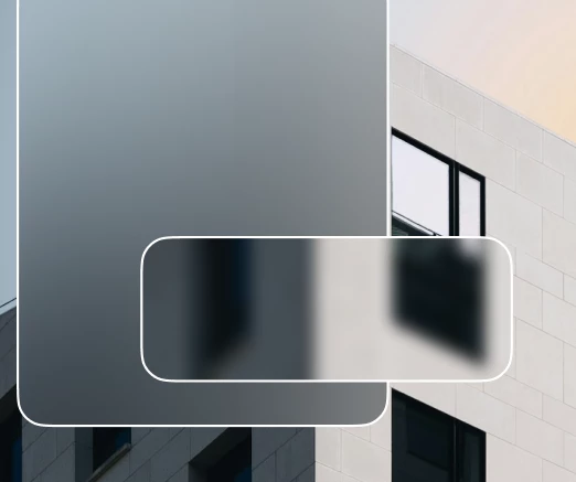

Background Blur doesn’t stack when overlapping layers
Does anyone know how to fix this? Or is it just a Figma bug?

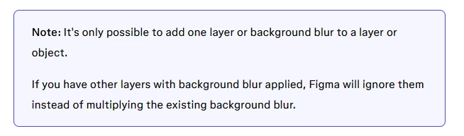

    Not a bug. Probably the only way to apply multiple background blurs is to rasterize the bottom layers first and then place a new background blur on top of them.

    You can also use a glass effect instead of a background blur for the second frame as an alternative
