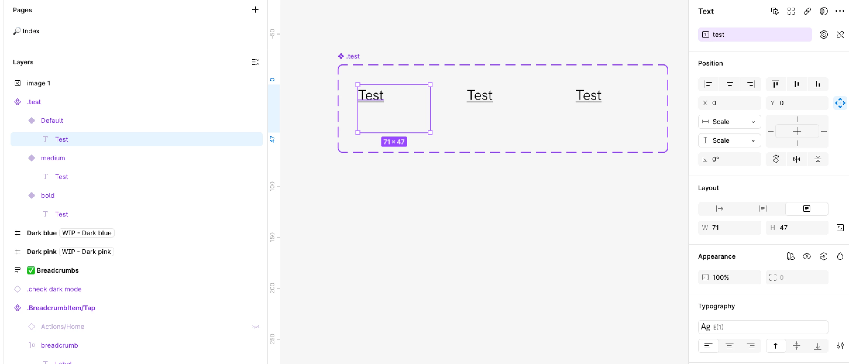

Here’s a screenshot to demonstrate the bug : I have several variants with differents text style linked to the same text property :
As soon as I underline one of the variant, it apply the override to all variants :
It’s probably a bug, since my understanding is that a text property is only about content itself, not the styling. So a styling override shouldn’t affect the text property value
