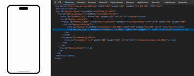

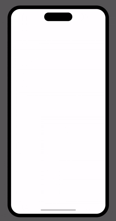

Original animation (viewed in Figma)

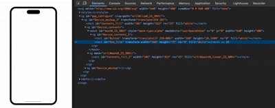

Exported SVG animation (viewed in Chrome)

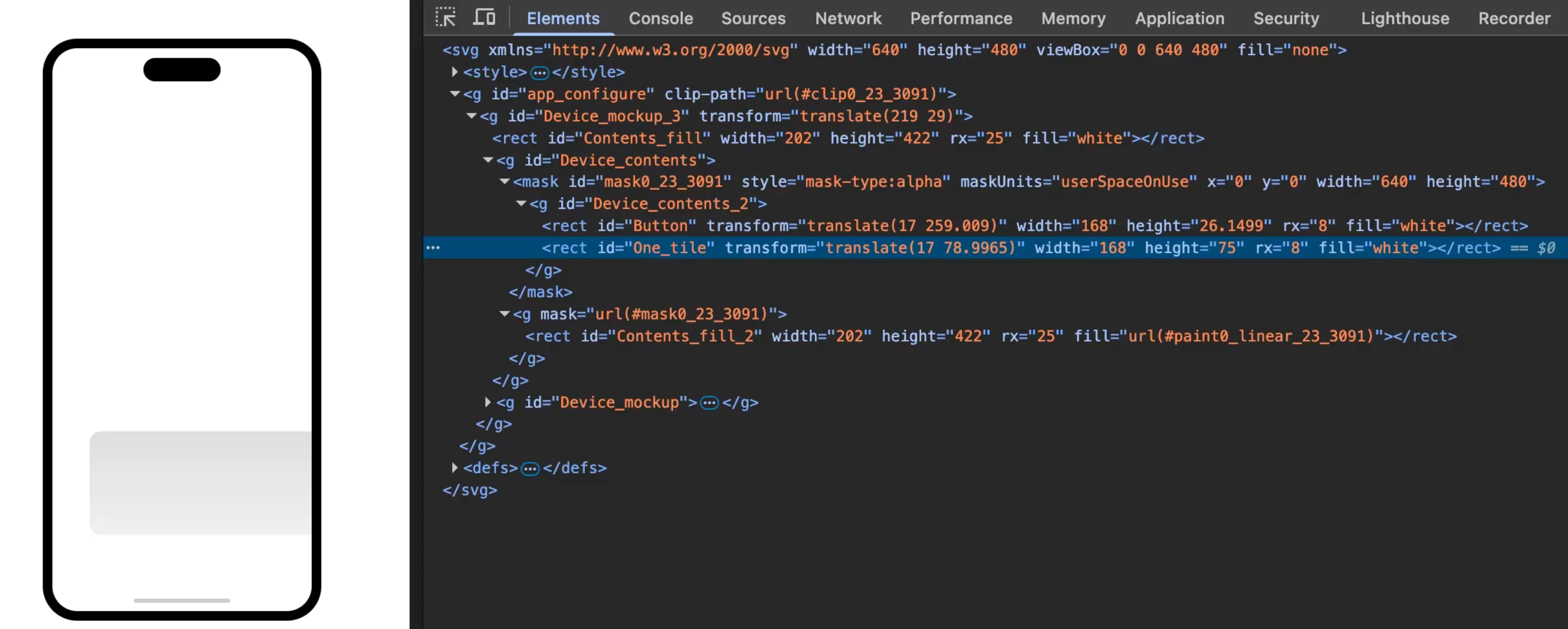

Exported SVG animation after removing the (transform=”translate(17 78.9965)” property (viewed in Chrome)
Screenshot of the relevant SVG code

<rect id="Contents_fill_2" width="202" height="422" rx="25" fill="url(#paint0_linear_23_3091)"/>
</g>
</g>
<g id="Device_mockup">
<g id="device_frame">
<rect id="iphone_frame" x="3.5" y="3.5" width="195" height="415" rx="21.5" stroke="black" stroke-width="7"/>
<rect id="camera_cutout" transform="matrix(1 0 0 -1 73 31)" width="56" height="17" rx="8.5" fill="black"/>
<rect id="home_button" opacity="0.2" transform="matrix(1 0 0 -1 66 409)" width="70" height="3" rx="1.5" fill="black"/>
</g>
</g>
</g>
</g>
<defs>
<linearGradient id="paint0_linear_23_3091" x1="101" y1="0" x2="101" y2="422" gradientUnits="userSpaceOnUse">
<stop stop-opacity="0.4"/>
<stop offset="1" stop-opacity="0"/>
</linearGradient>
<clipPath id="clip0_23_3091">
<rect width="640" height="480" fill="white"/>
</clipPath>
</defs>
</svg>

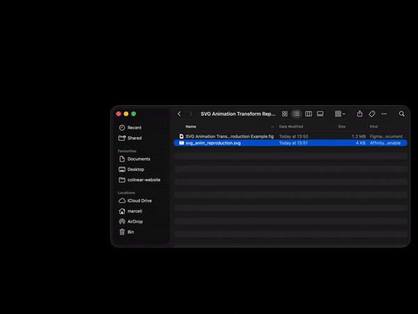

Marceli Wac
Jul 15, 2026 12:53 PM UTC
Dear ​@adamsmasher and ​@Lauren_Budorick,
Thank you for the prompt reply! This doesn’t happen with some examples, and in fact, I tried simplifying it further by removing some animation steps and content tree, but at some point the problem goes away (hopefully this should hint at where the issue lies).
I’m attaching a fairly minimal reproduction example. The example has some additional guides to point at where the frame should at different keyframes. If you need anything else, please feel free to reach out!
Marceli Wac
Jul 15, 2026 1:02 PM UTC
Somewhat interestingly, when I open the same SVG file (included in the archive) in MacOS’s preview/quick look (not the Preview app, but the long-press from Finder), the animation renders fine!
There is a chance this could be an issue with the browser’s SVG renderer…
Previewing the “faulty” file in MacOS
