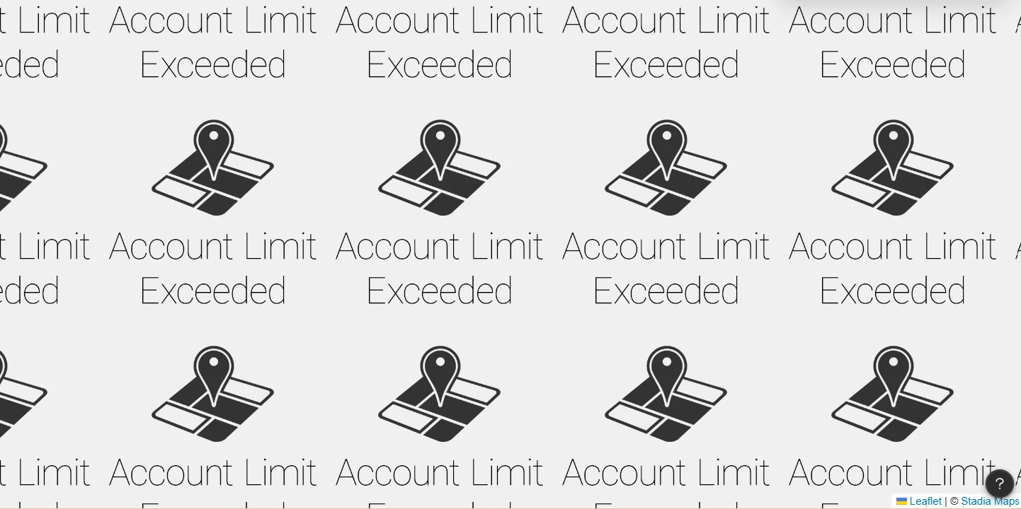

Hello Community,
Hope you are all keeping well.
I had enrolled in the education tier pro version of Figma and been actively creating a personal project via an interactive map through leaflet plugin and suddenly at random have received "Account Limit Exceeded" plastered over the entire map?
“Account Limit Exceeded” issue for Leaflet Maps when it hasn’t been used at all this month.
I have not even built anything this month, nor have I used any AI credits on Figma or Leaflet plugin for the month of March, so this seems odd since I have been very careful and have rationed my usage of credit allowance. There have been barely any visits to the created interactive map as it is a closed shared project between 2 people so there’s literally no chance for API calls on my behalf to keep the site active.
Based on my research, it is apparently a SheerID verification lock based on Figma forums, reddit and stack overflow responses but I got a response from SheerID stating there is no issue from their end and I am unable to reach Figma support either.
Rest assured, I have full educational tier access and have verified my educational tier through SheerID and I'd be happy to do so again if necessary.
Please help me out.
Thank you all for viewing and considering to help me resolve this issue. Massively appreciated.

19kek94Solution
Mar 29, 2026 6:07 PM UTC
Never mind people. I resolved the issue myself. I was dumb not to see it on first go.
The issue stems from map tile provider quota limits and has nothing to do with Figma or SheerID.
The provider Stadia Maps had reached it’s usage limit due to it being a shared common community key that the leaflet plugin utilizes. All I had to do was to change to a better provider for my map with more usage and I chose CARTO since it has education tier allowance itself and migrated to it.
Easy fix and if anyone needs any help with this in the future let me know.
