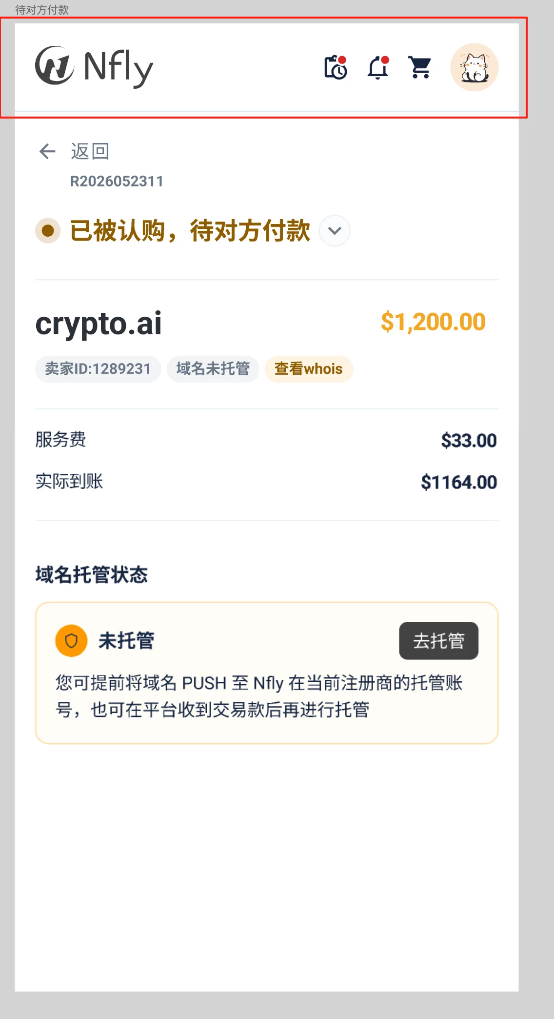

使用手机浏览器预览设计稿,顶部标题栏区域设置的交互点点击没反应。

weiminhui
使用手机浏览器预览设计稿,顶部标题栏区域设置的交互一直不生效。
✅使用电脑点击交互时可以生效的,
✅移动端的figma APP预览页面点击也是可以生效的
❌❌只有使用移动端的浏览器预览页面是点击会不生效,并且只在顶部标题栏区域。

Hey ​@weiminhui, thanks for reaching out!
I'll continue in English since that's the language I can best support you in here. Please let me know if anything's unclear.
Here's what's likely happening with the top title bar interactions not responding in a mobile browser: when you open a prototype link in a mobile browser, Figma shows your design inside a normal browser window. So the browser's own address bar and toolbar stay on screen (usually at the top or bottom). You can read more in our Help Center article on viewing prototypes on a mobile device.
The Figma app doesn't have that browser UI, which is likely why the same interaction works there. If your viewers don't need to open this specifically in a browser, playing the prototype in the Figma app would avoid that overlap.
It's also worth checking what trigger is set on that top hotspot. Is it On click/On tap, or Mouse down/Mouse up? These can behave a little differently on touch devices, so if yours is set to Mouse down/Mouse up, try switching to On click/On tap and testing again in the mobile browser.
If neither of those resolves it, could you let us know which mobile browser and OS you tested with (e.g. Safari on iOS, Chrome on Android)? From there, I can get you connected with our customer support team, and you'll be able to share the file with them directly so we can take a closer look.
