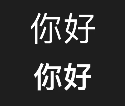

@任爽爽 Thanks for the screenshot! Our engineering team is now investigating as this should be showing for you - once I have more information on a resolution I will let you know. Thanks so much for your patience!

I’m using Figma on macOS. Two text layers both show PingFang at 14px, but the Regular text appears noticeably larger than the heavier-weight text. Both lines in my screenshot contain the same Chinese characters, “你好”. The difference is in the overall glyph size, as well as the stroke thickness.
