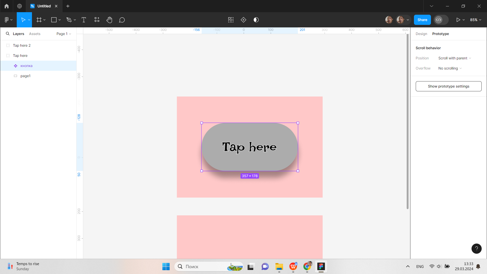

Azhar2
March 29, 2024
for ex.: like that…
djv
April 1, 2024
Hey Azhar, thanks for providing a screenshot!
I tried to reproduce your file, but I’m still not having any issues getting Interactions to appear.
Can you please provide a link to your file and share edit access with support-share@figma.com, so I can take a closer look at how you’ve set up your layers?
Haroll
HarollAnswer
Power Member
April 1, 2024
Hi @Azhar2
Interaction are only availbale when working on a object or a frame. Your component is made of a frame but is inside a group and that prevent it to work.
You may
  • remove group “Tap here”
  • turn it into a frame
  • or include it in a frame
More details on Figma’s documentation on creating interactions
