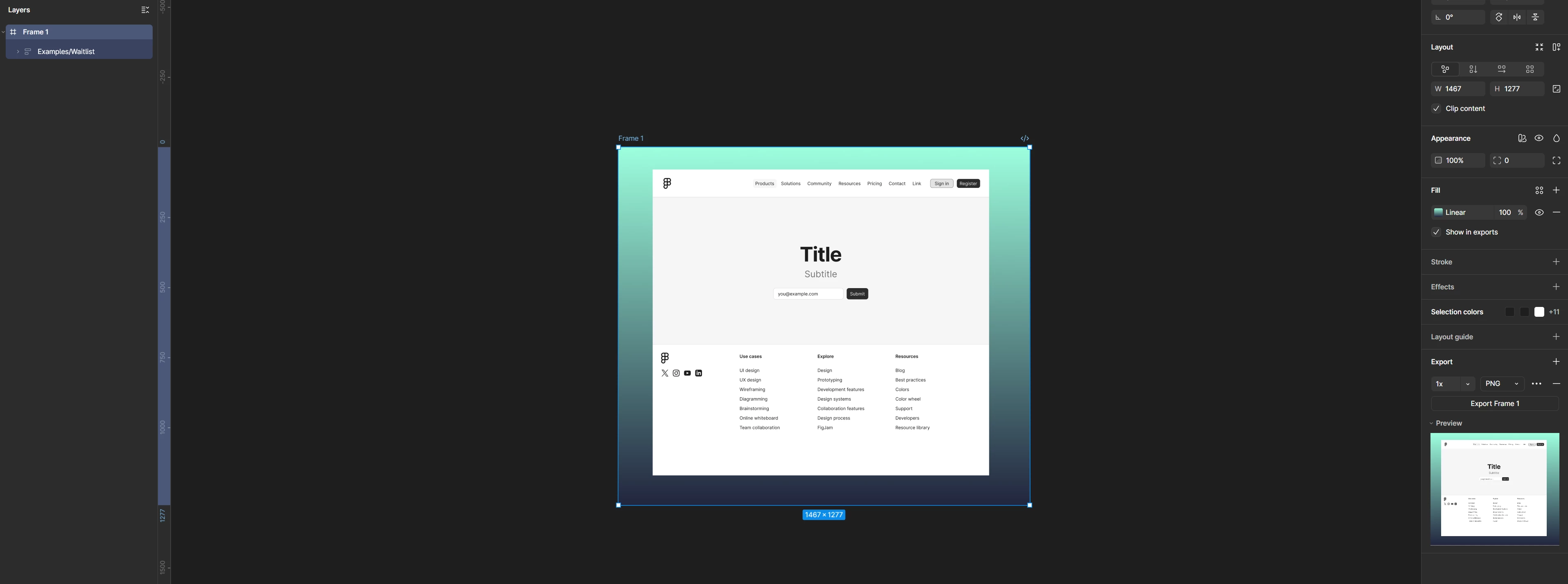

Why doesn't Figma export gradients?
​​​​Example of Figma NOT exporting the gradient
I set a gradient in the Fill and when I export the image the background will NOT contain the gradient fill? why is that?

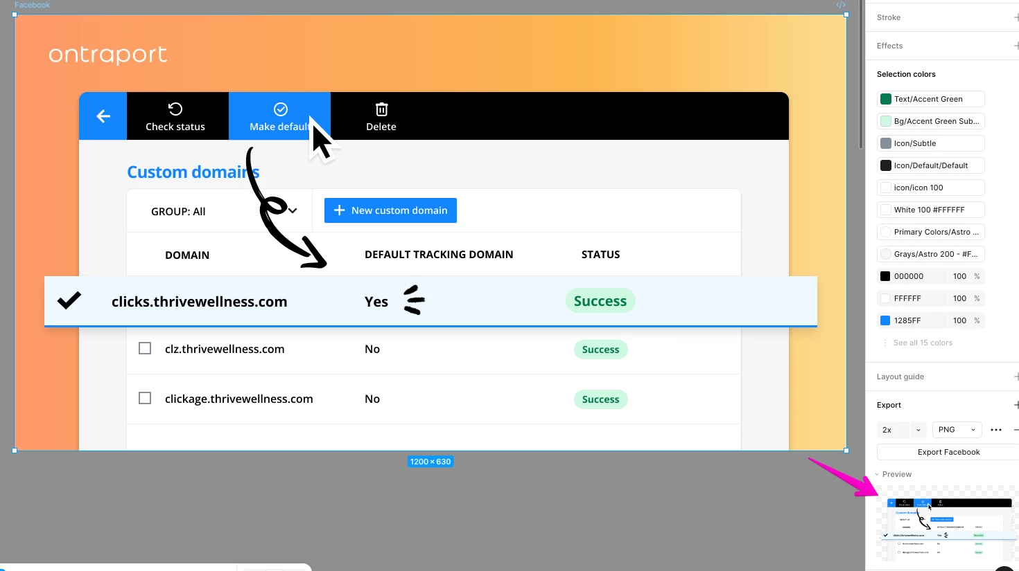

Hi ​@Jonathan Warrecker ,
it’s working fine for me.
Could you please check if all the layers are placed inside the frame before exporting the artboard? Sometimes layers outside the frame don’t get included in the export.
Let me know if that helps! 😊
Here is the examples below

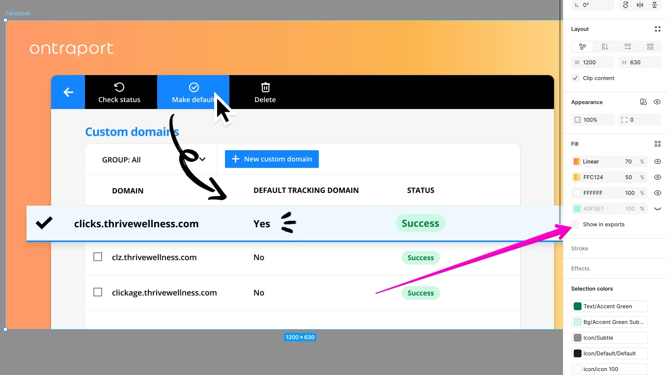

Jonathan Warrecker
Jul 23, 2025 1:24 AM UTC
well shit
there’s my problem right there!
geese what an idiot!
Jonathan Warrecker
Jul 23, 2025 10:14 AM UTC
thank you! Because of you I realized the “show in export” checkbox needed to be checked. Doh!
