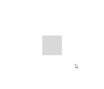

Why do the Figma hover and clicked effects not work together? Is there any solution to these problems?
I'm facing an issue in Figma. I want my button to have a hover effect with a click. But unfortunately, I can't do these 2 things together in Figma. Is this only in Figma design, or does this type of button not work in development as well? Thanks

You can have three component variants, and add a while hovering interaction for the first step, and while pressing for the second.
