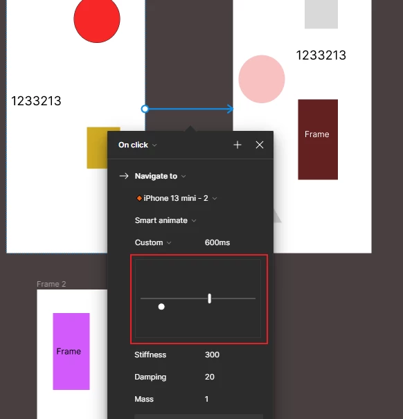

Step 1: I used the Figma UI tool to add interaction to these two frames.
Step 2: I selected the frame on the left and executed this command in the console.
figma.currentPage.selection[0].reactions = figma.currentPage.selection[0].reactions
Result: The solid line in the image disappeared, and the animation effect during the Flow is also different.
Why is this happening, and how can I solve this problem?

Thank you for your reply. I’m trying to recreate the problem I ran into using the example you mentioned above.
As a novice in Figma plugin development, I want to add interactions by modifying the “reations” attribute of a layer through Figma API. However, when I configured the action in this way, the actual effect produced was different from that added through Figma UI. I compared the “reations” attributes of these two methods through the console and found they were exactly the same.
I wonder why the actual effects would be different? Did I miss any value? The command mentioned above is to demonstrate that even if I give “reations” a value exactly the same as the original one, it would also produce an effect different from the original one.
Here is the link Figma Demo
The above interaction was added using Figma UI, and the below interaction was added using Figma API.
Could you please confirm this for me? I really appreciate it.

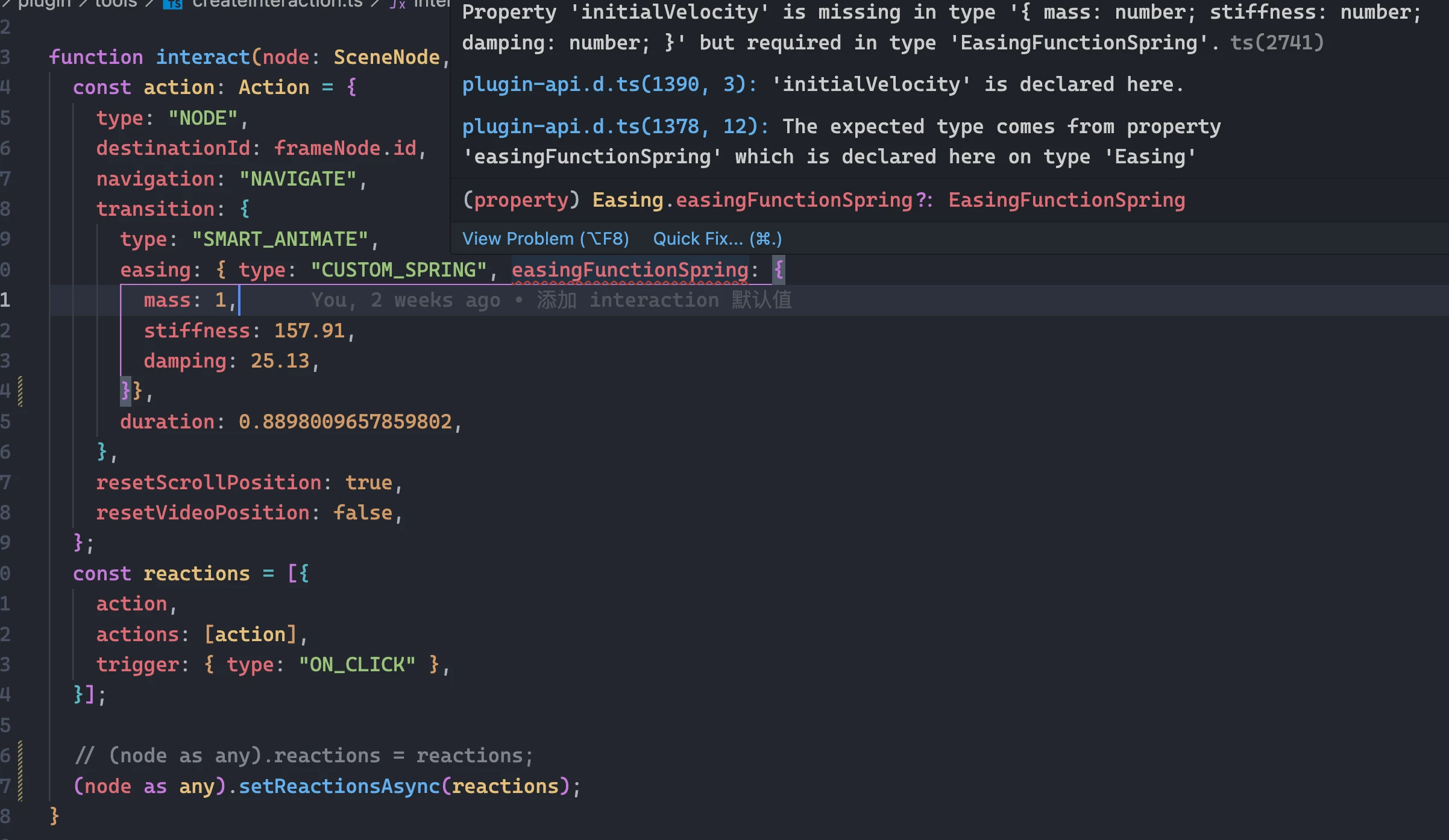

Here is my code to create interaction.
function interact(node: SceneNode, frameNode: FrameNode) {
  const action: Action = {
    type: "NODE",
    destinationId: frameNode.id,
    navigation: "NAVIGATE",
    transition: {
      type: "SMART_ANIMATE",
      easing: { type: "CUSTOM_SPRING", easingFunctionSpring: {
        mass: 1,
        stiffness: 157.91,
        damping: 25.13,
        initialVelocity: 0,
      duration: 0.8898009657859802,
    resetScrollPosition: true,
    resetVideoPosition: false,
  const reactions = [{
    action,
    actions: [action],
    trigger: { type: "ON_CLICK" },
  // (node as any).reactions = reactions;
  (node as any).setReactionsAsync(reactions);
I read the document and tried using these two different APIs to create interactions, but the results were the same.
I have tried other transition types, such as Custom Bezier, Ease In, etc., which worked as expected, but Custom Spring did not.

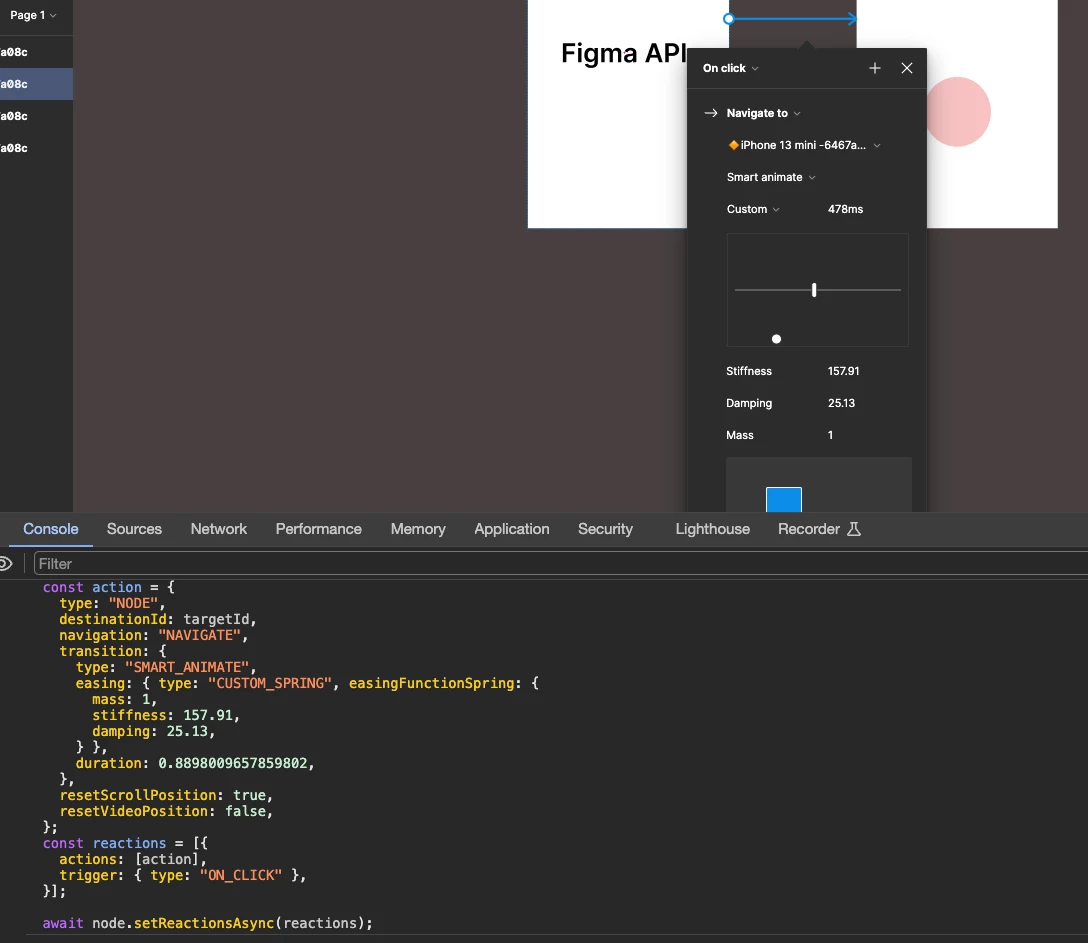

I tried to remove initialVelocity, and then there was a type error warning. I suppressed the warning and ran the code, but the result was still the same.
These are the versions of my related dependencies.
Figma: 116.17.11
// package.json
"@figma/plugin-typings": "^1.50.0"
To make it easier to see the effect, you can select two frames first and copy this code to the Figma console and execute it to see the result.
  const node = figma.currentPage.selection[0];
  const targetId = figma.currentPage.selection[1].id;
  const action = {
    type: "NODE",
    destinationId: targetId,
    transition: {
        mass: 1,
        stiffness: 157.91,
        damping: 25.13,
    action,
    actions: [action],
  node.setReactionsAsync(reactions);

I tried removing the action field, and the result was the same.
    actions: [action],
Then, I restored the code and added the await keyword, but the result was still the same.
    action,
    actions: [action],
  await node.setReactionsAsync(reactions);
Finally, I tried combining these two methods, but the result was still the same.
    actions: [action],
