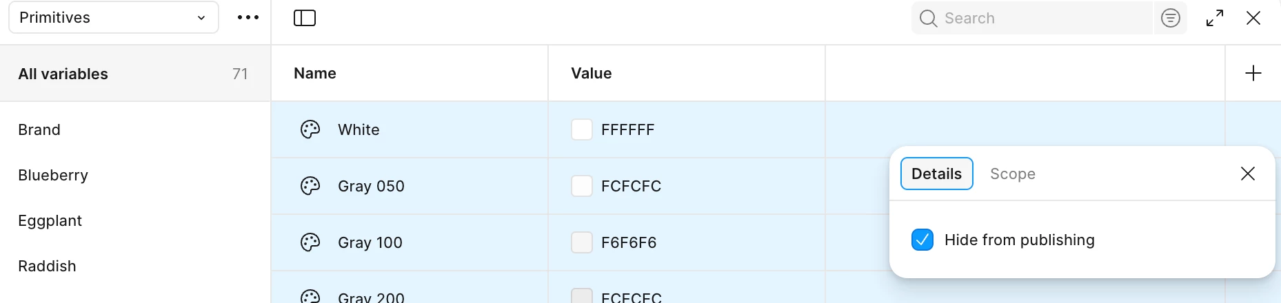

All the primitives have been selected to HIDE and it still shows up under APPEARANCE. Why?

Did you ever publish them previously? If yes, and you only recently checked that hide from publishing box, you will need to push out a new update to “hide” them.
Are you in the same library file that they are defined in? Hiding them from publishing won’t prevent them from showing in that file.

I have published previously I’ve always checked “hide” for a while now and there have been numerous published since then. Still shows up.
I am in the same file it’s defined in, but it shows up in other files when the design system is added.
