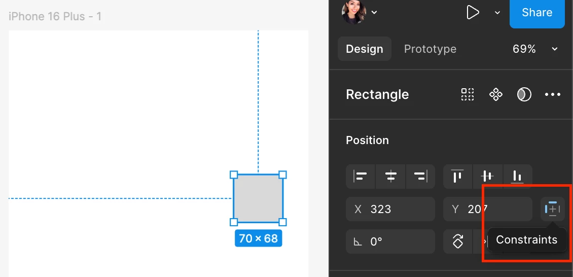

Where is the "Constraints" setting for scrolling in the right-hand panel? I can't find it to enable vertical scroll
Hi Figma community,
I'm designing a long scrollable screen within an iPhone 16 frame (H:852px). My content extends beyond the bottom of the frame, but I cannot scroll in Prototype preview.
I was advised to select the frame and find the ​​"Constraints"​​ section in the right-hand Design panel, then change the setting from ​​"No scrolling"​​ to ​​"Vertical scrolling"​​.
​​However, I cannot locate this "Constraints" setting at all in my panel.​​ My panel mainly shows style options like fill, stroke, and effects.
Could you please guide me on how to find or reveal this option? Is it hidden somewhere?
Thank you so much!
    djv
    Sep 19, 2025 9:00 PM UTC
    Hi ​@yangjiabao, thanks for reaching out!
    Constraints are now located in the Position section of the Design panel. You’ll see a tooltip appear that says Constraints when you hover over the icon:
    Hope this helps!
