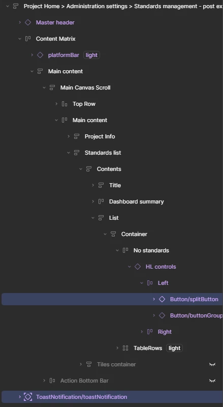

Hello, I'm having a similar issue.
I have a fading animation track placed on a toast notification using Motion:
The fading animation track created on the Toast Notification component instance.
This Toast component instance is placed at the root of the Screen frame the toast is appearing on.
Elsewhere on this screen, and inside another frame “Content” for that screen (i.e. different parent frame than the Toast Notification), I have a button that triggers an overlay menu when clicked. This button is actually part of another Component Instance:
Here is the hierarchy of that screen: selected are the Button triggering the overlay, and the Toast Notification featuring the Motion fade animation.
When I play the prototype and click on the Button instance to open the overlay, the Toast Notification reappears, plays its animation again. This motion animation is configured to NOT loop. It's triggered without any interactions aside from arriving on that screen from the previous one. It's not nested in the same frame as the button.
Any ideas?
