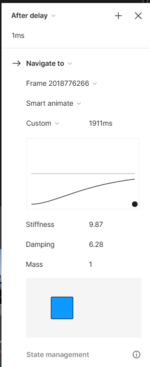

What the equivalent of initialVelocity when using Spring animation from Figma?
Hi 👋
When playing with Spring animation, you can change Mass, Stiffness and Damping values.
Regarding iOS Guidelines for Springs, we are missing the initialVelocity to use this transition on iOS. It should be a number between 0 - 1.
Does anybody know this value or how to calculate it?
Mar 29, 2024 7:41 AM UTC
I think the initial velocity is 0. You can see this animation curve, the initial slope is 0
