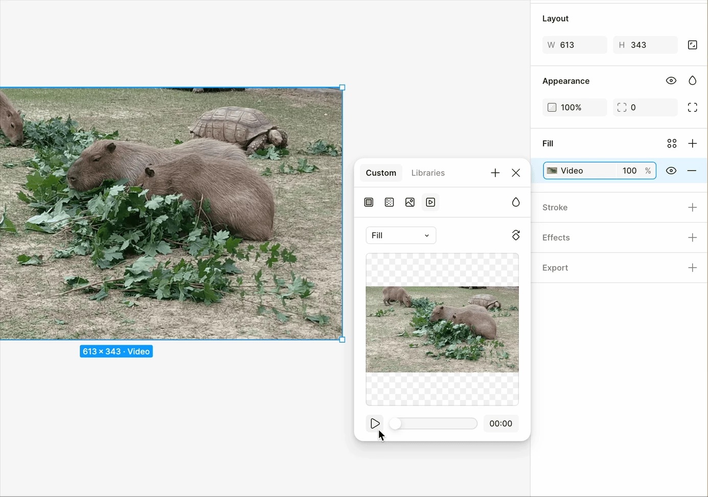

Regarding duration controls: when a video is added as a Fill, you can manage it in the Fill section of the right sidebar. From there, you should be able to:
  • Preview/play the video
  • Scrub through it
  • Jump to a specific timestamp
There isn’t a separate “Duration” tab,  playback is controlled directly within the Fill settings.
