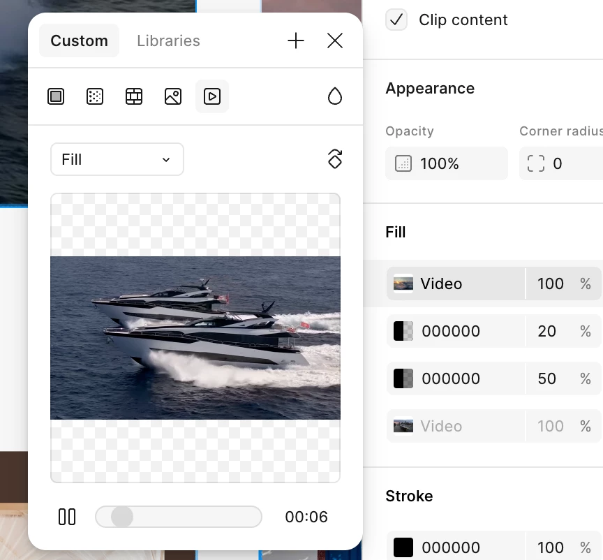

Video autoplay on Figma Sites
I’m trying to add a video as a background in Figma Sites. The video previews in the fill window (see screenshot) however it does not play when I preview the whole site.

Jun 10, 2025 3:30 PM UTC
Hey ​@55Will , Celine from Figma here!
Figma Sites doesn’t currently support native video uploads. So, if you try to upload a video as a fill, it will not playback in the Preview view and you will see an issue flagged on attempting to publish the Sites file indicating that your file contains an unsupported fill.
To add a video, we recommend using a YouTube embed, or the generic URL or HTML embed if your video is hosted on a different platform.
You can learn more on how to use these feature in our Help Center article here: Insert blocks, embeds, webpages, and design libraries into a site.
Hope this clarifies!
