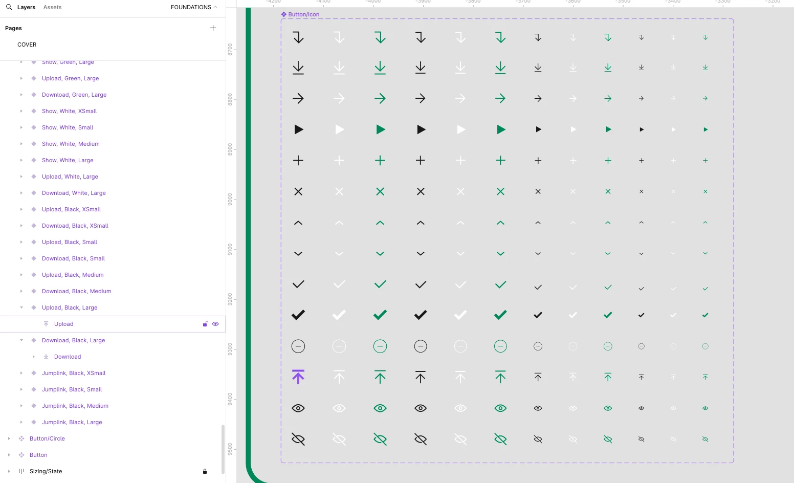

I have my icon component in my library file, where I’ve set all my icon variants in different sizes and colours as I need them specifically for my projects.

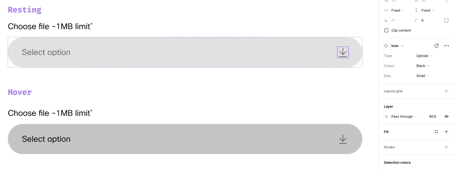

When I’m editing another component which uses an icon in it, as seen below in the form field, I have an issue when selecting the “upload” icon specifically. It keeps displaying the download icon - which fair enough they are just reversed from the similar paths, but I have outlined all the upload instances and re-named them.
I show here the form field, but I have encountered the same issue everywhere I tried using the upload/download icons. Any ideas why this is happening and how to rectify? I’m almost certain it’s something basic, and I’ve missed it, but any help would be highly appreciated.
