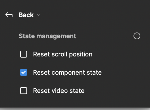

Hey @Ian13, thank you for reaching out!
Do your states consist of component variants? If so, have you tried checking off Reset component state in the State Management section of the panel? If you need the menu’s state to be reset (back it’s default state)for the previous page. You can set the state management to Reset component state. It’ll reset to original component state, as set on the canvas.
Screenshot 2024-02-29 at 13.47.53
I’d recommend to check our Help Center article: State reset
If this does not solve your issue please share a screenshot of your conditions or share a copy of your file with me if possible. Please invite support-share@figma.com directly as an editor (this won’t affect your billing at all), happy to help further.
