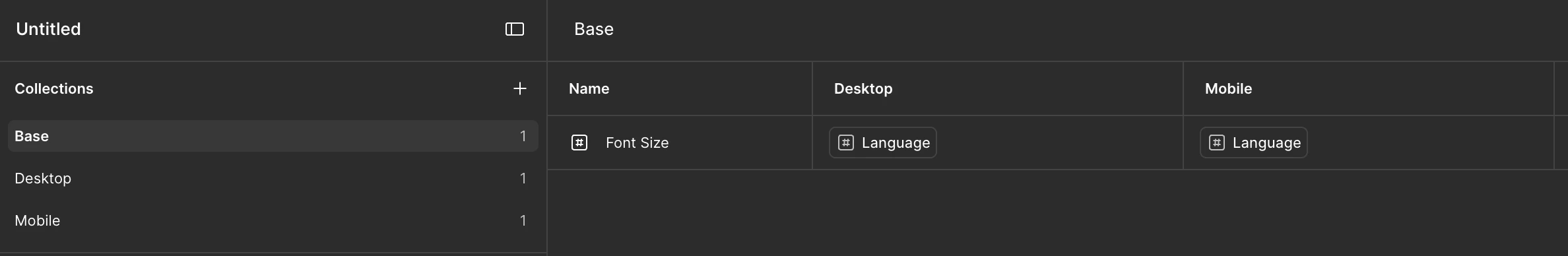

The screen size collection is defined on Base.
Base uses the two collections as variables

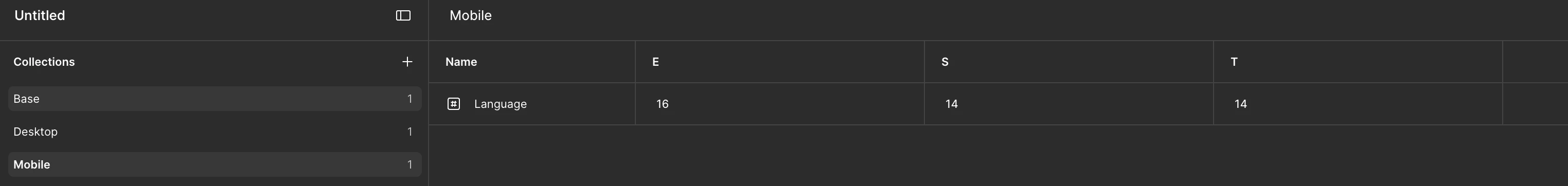

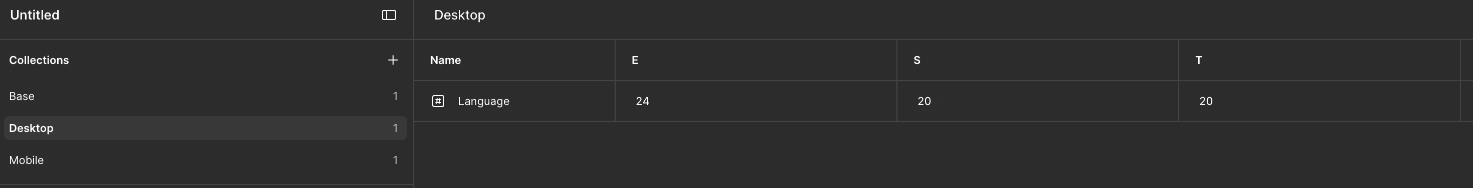

this two uses the Mobile and Desktop collections as varibales each containing three varibale modes for the 3 languages.
Mobile collection and its size variables across E, S & T
Desktop collection and its size variables across E, S & T

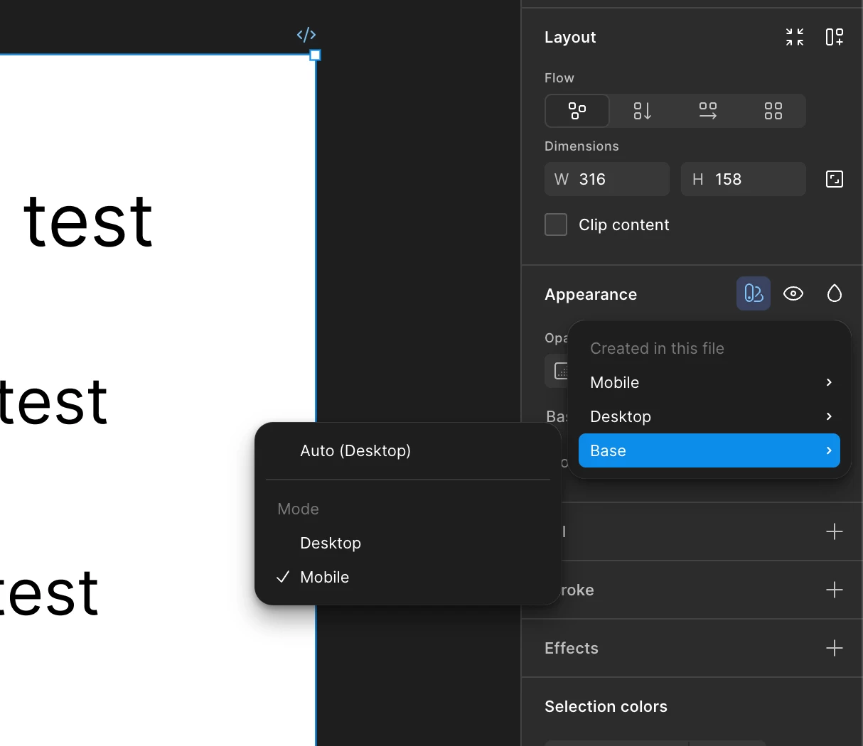

I want to be able to switch the screen size and language separately without selection language seperate for each screen size (Desktop vs Mobile)
I can’t seem to find a way to do this in Figma Variables. Has anyone solved something similar or found a good workaround?
