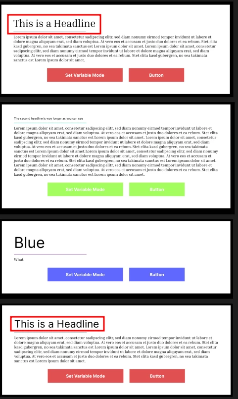

I have been experimenting with the Variable Modes and i could figure most things out but i feel like this one might be a bug since i coulndt find anything about it - But just in case i wanted to ask here first.
I created a Collection with 3 Modes, that change colors, Text content and now its supposed to change the Font Type and size of the Headline.
This works perfectly fine in the Workspace, but when i check the prototype the Font wont change. Furthermore, when i loop back to the first font the innate Font is changed to Inter.

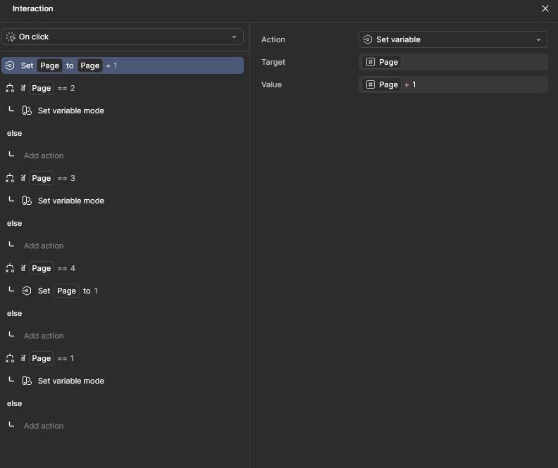

In case its relevant - I loop the Modes by having a seperate colltecion with one number. The button sets number to number+1 (until it hits 4, then it resets to 1) and checks what the variable is set the mode. This worked perfectly fine before i started to test the font change, so im unsure if its relevant.
Anyone gut any idea what the issue might be?

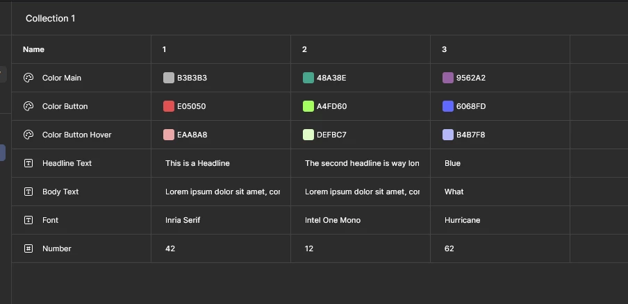

Hello Jaycee, thank you for your answer. The Used Fonts are all google Fonts. The variables are shown in the first image of the post :) The action order seems to be fine as it doesnt have any issues with the other variables (color, Font size etc)

Hi, ​@GDThre3 thank you for taking the time to update our thread. If you find this to be consistently reproducible, opening a support ticket is going to be a good next move. If you have a moment, can you set up one more quick test?
Font variable, no counter
  • New file. One frame, one text layer, one collection with 3 modes — each mode pointing to a different Google font (e.g. Inter / Roboto / Lora).
  • Duplicate the frame 3 times and apply a different mode to each
  • Open the prototype and click through the frames manually. Does the font swap cleanly?
Add the counter back (if successful)
  • Rebuild your counter setup in the same file and click through with a button

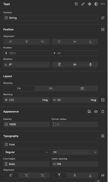

One follow up - with your headline in the original file, is the font applied directly to the text layer, or is there a text style applied on top? Screenshots of your variables panel + the headline's typography section + the button's interaction panel will be helpful for your support ticket.

I rebuild it and it works perfectly fine - as long as you only change the Font. When i change the String and fontsize as well it now works for one loop (which it didnt before), but resets to Inter once you return to the first Font.
Changes are only applied to the text layer.
Here are the screenshots:
Swap Logic
Would you like me to test anything else or should i proceed to open a ticket?
