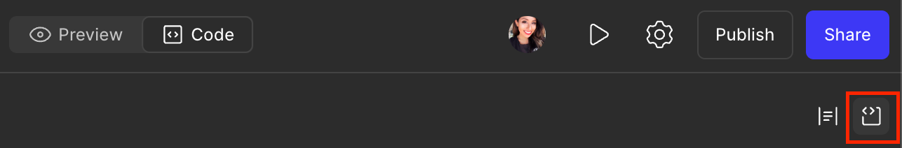

Hi ​@alpa, thanks for reaching out!
I passed your questions onto our Figma Make team, and here is what they’ve reported back:
You can download the code into a .zip file from the Code tab via the Download code icon shown here:
There currently isn’t a way to only export the design or export a Figma Make file into a Figma Design file, and right now, plugins are not available for Figma Make. They’re saving your feedback and feature requests for consideration and future improvements.

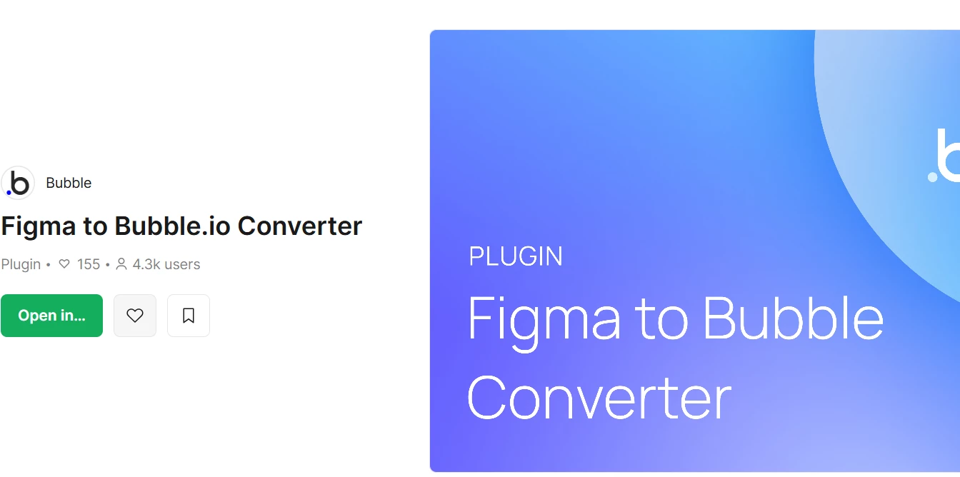

Hi,
I have a similar doubt to alpa. I have built a Figma Make project. However, I’m having big difficulties to export it to Bubble.io. When I try to install Figma to Bubble converter, I cannot open it in my Figma Make project, it is not listed. Thus, I don’t know if my design is exportable to any other frameworks. Can you help me, please? I’m a paying user with Full mode.
djv
September 9, 2025
Hi ​@Jeibros, thanks for reaching out and apologies for the delayed reply!
From what I can see, this plugin was created to only be compatible with Figma Design, not Figma Make. Again, plugins are not available for Figma Make yet.
If you have any additional questions about the Figma to Bubble.io Converter, plugins are supported by their creator. Please reach out directly via the support email listed on their community page: support@bubble.io
