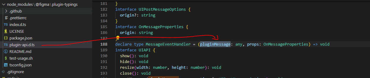

it is the highlighted one in previous code snippet
It is something from here…
