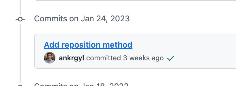

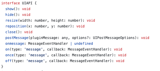

JosephxBrick
Active Member
Feb 10, 2023 10:46 PM UTC
It’s odd because when you go to the github repository, the file does contain the reposition function:
…but the file in v1.58.0 (under “tags” in the repository) doesn’t have it.
I modified the file locally, and the IDE stopped complaining about it and there were no console errors when run, but it didn’t work reliably - e.g., it only repositioned the window occasionally, whereas the “resize” function used in the same spot worked every time.
