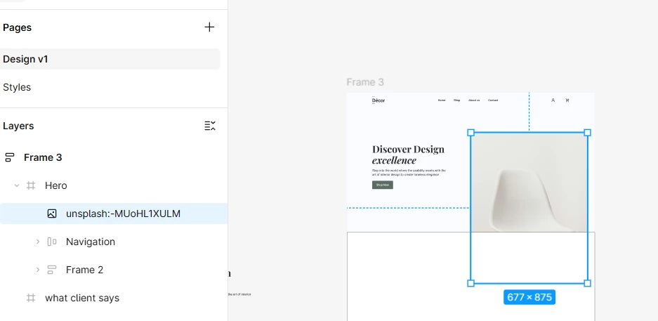

I created 2 frames (hero and ‘what client says’. Both of them are within auto layout frame - frame 3.
What I want to do is to make a chair picture come out off the hero frame yet it is being clipped inside.
All of the frames have clip option disabled. What do I do wrong?

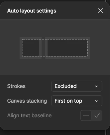

    Hi ​@mediolanka ,
    Click on the frame 3 and choose the auto layout seetings and change the canvas stacking to “First on Top” I hope this will solve the problem. Please let me know if it works for you!
    Happy to help you 😊, Thank you
