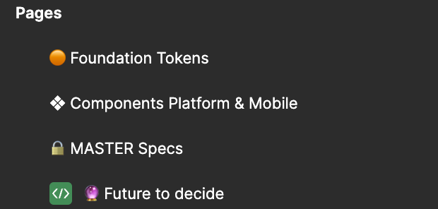

Hey, what I did was to combine the two really. So the components page combines the components on platform and mobile in separate sections for both (being the components in production). The Future to decide is component upgrades/improvements based on feedback and so on.
It depends on what you’re trying to achieve. With your last comment, if you have a DEV and PROD then the core lib one, for them to share the same tokens/variables, you can set up the tokens in the core and copy paste all the components into the core, but will have to attach the tokens/variables to all components. Even if you add the Core lib to the other 2 libraries the DEV and the PROD, I don’t think there is a way where you can share the variables/tokens between them, I think you would have to set this up again individually for each file. But I may be wrong.

@Imzzy Thanks for your comment! Your approach makes sense, if you don’t make your library public. In my case, I can not shаrе my work in progress (your page “Future to decide”) with the world. I really have to keep this in a separate file.
Regarding the variables, I just can’t imagine that they can’t travel from a core library to multiple working files. This would be a serious downside of this feature… But who knows. Gonna check this.
